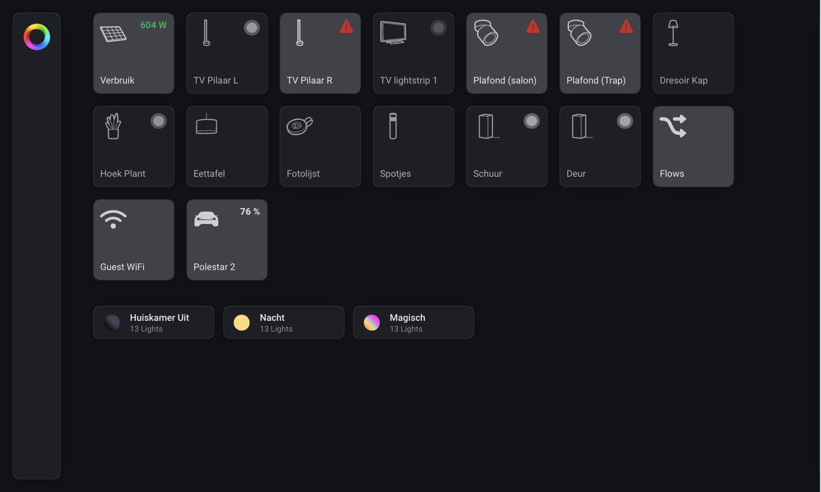

Last week i moved from a custom homeydash variant to just use https://my.homey.app
On a rather small screen the my.homey.app interface i preferred to have a more minimalistic design. Chrome extensions like stylebot are a great tool to change the look and feel of a website, and thus ideal for this use case. Have a go on your computer with it and see how easy it is to hide certain parts of the interface.

Copy the folder with the two files (manifest.json and styles.css) to the system you want to use the changes on. in the browser go to extensions, open from extracted folder and select the folder. you have now build and used your own browser extension to change the look and feel of my.homey.app.
