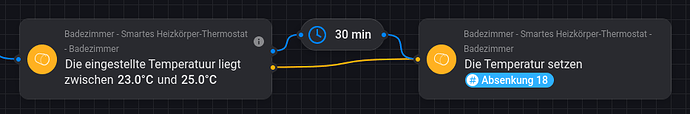

Thanks, from what I understand my setup should work. The pointer to Chronograph is helpful indeed, I could enhance the flow to take open windows into account (turning off the heating) …

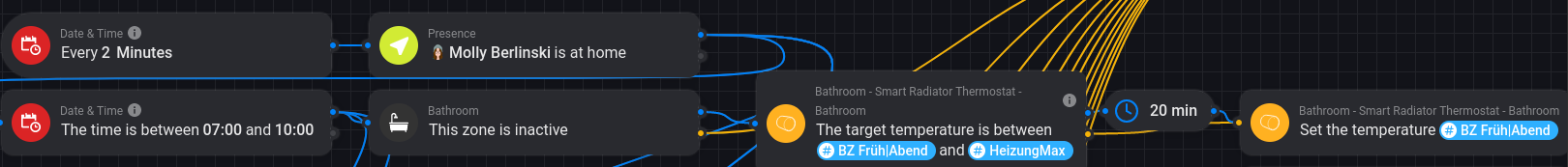

my approach doesn’t work. The 2 mins When overwrites the 20 mins delay. Any idea what I’m missing?
The goal of this flow is that
1.Every 2 minutes the target temperature is set to a specific value (A) except
2. If it’s manually set between two different values (B,C) then it should not set to (A) for 20 minutes
thinking:I might miss the When card “The target temperature changed”. If true it’s getting complicated, no?
I think I found a way how to deal with it - with a set variable. Currently testing it. It’s not super-elegant though

I’m trying to understand how your flows are supposed to work. But that is difficult for me. Also because your screenshots always only show sections and I can only guess which cards are connected to which cards.
Because why? Logic variables can be very useful. I have about 130 logic variables in use.
In your case you have to remember to set the logic variable AufheizenWZ / BZ to No again. Under whatever conditions.
the canvas is too big to make screenshot. I set the variabe to NO after the delay card finishes. I use one “set to NO” for different delays. Currently checking if this works.
that’s the current status
