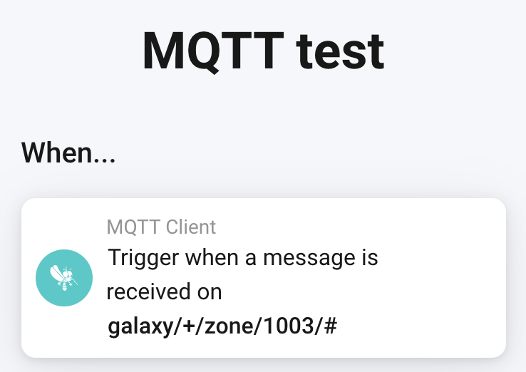

I’ve been playing around with the GalaxyGateway @Tjeerd made this weekend; connected it through the Ethernet module and RS485 to my Galaxy Flex alarm system and linked it to my MQTT broker on the NAS.
Working quite well and the response of Tjeerd on some questions / suggestions is really fast!
MQTT information as visible in MQTT-Explorer showing the state of the different zones, ability to control the output / groups and events (SAB RESET MANAGER):
With the MQTT Client app it is already possible to trigger based on the MQTT topic updates; in this case based on any update of zone 1003; but can be made more explicit off coarse.
