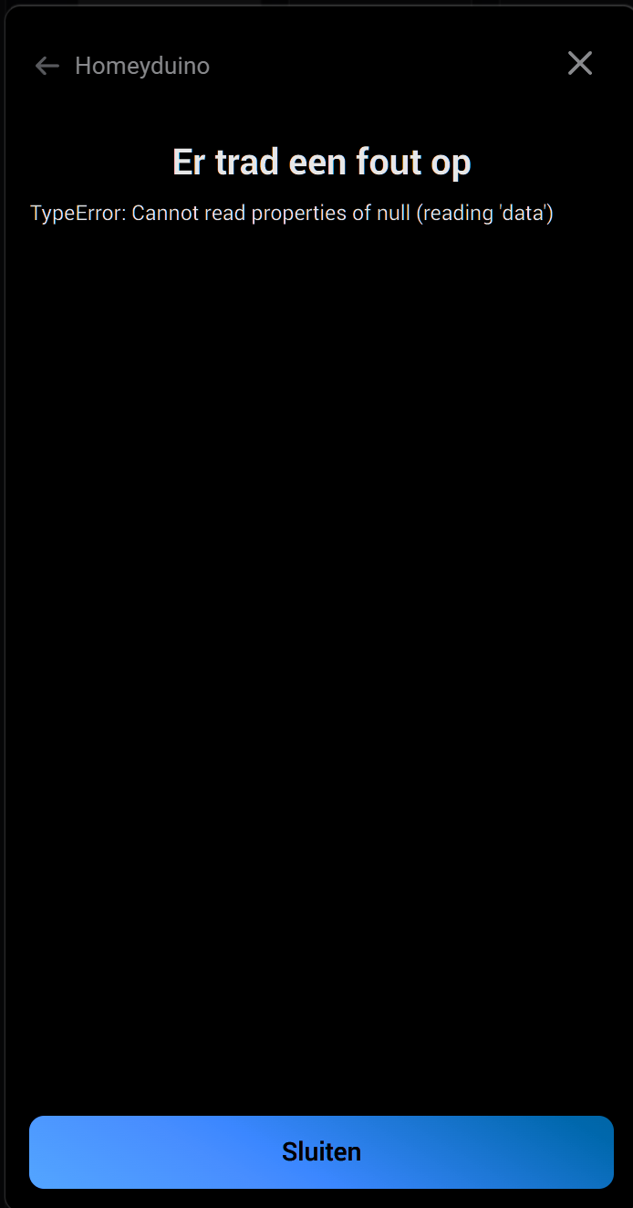

I got an Arduino MKR wifi 1010 in combination with a RS485 shield for modbus RTU control of my mechanical ventilation (itho Daalderop HRU 400). I got the Arduino on the wifi network, however I cannot add the Arduino to my Homey; I get the following errors:
and after adding the IP manually:
I can ping the of the Arduino just fine so it is connected. I did add the “Homey.begin(name);” to the setup part and “Homey.loop();” to the loop part in the Arduino code. Also tried some of the example code but that gave the same result. Anybody has an idea what is going wrong here?
