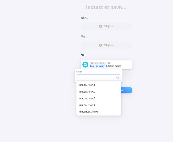

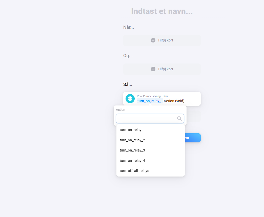

Haven’t really tried controlling output directly from homey.
What I have done is that I created actions in arduino code, those I can then trigger/start from homey, and in those action some things are happening like setting an output.
