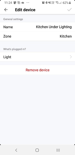

All drivers have an icon.svg and both large.png and small.png. The Homey app shows it for my RF bridge device:
However, that’s the only device I have paired with Homey at the moment, so can’t check if perhaps there’s something wrong with the files for other drivers. Perhaps @chinswain can tell me what types of Sonoff devices he has paired with Homey.

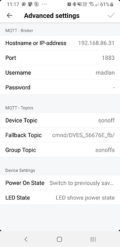

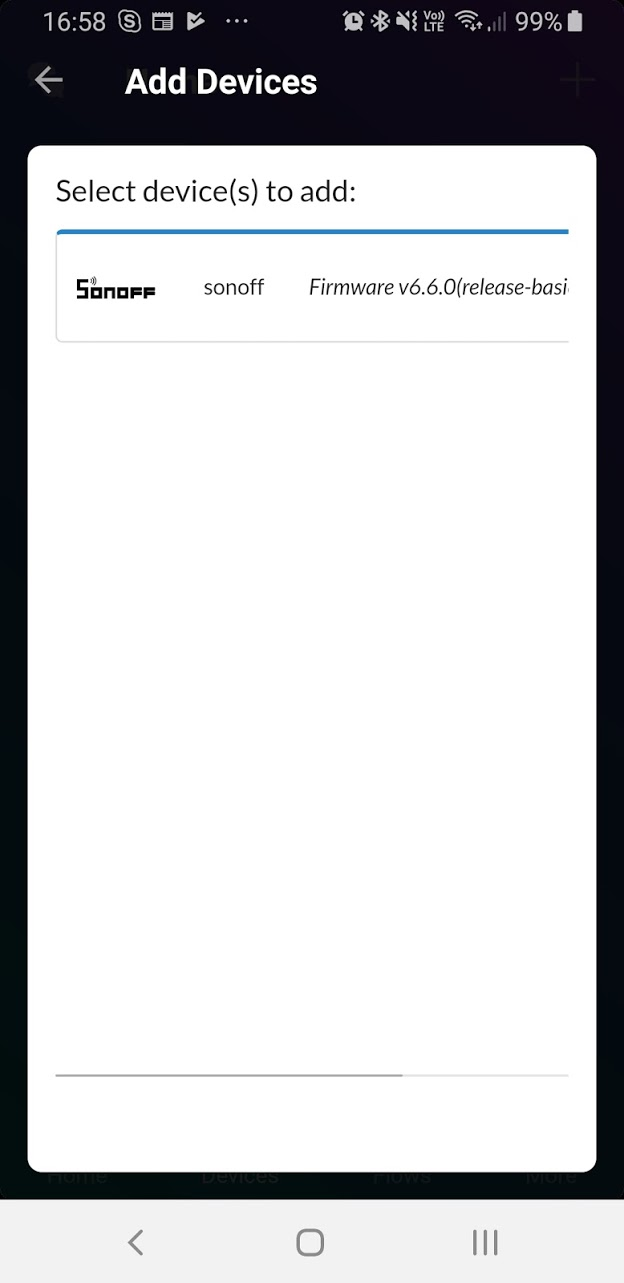

One device is a Basic (Original) and the other is a Generic (Tasmota):

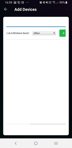

Icon’s show when adding:

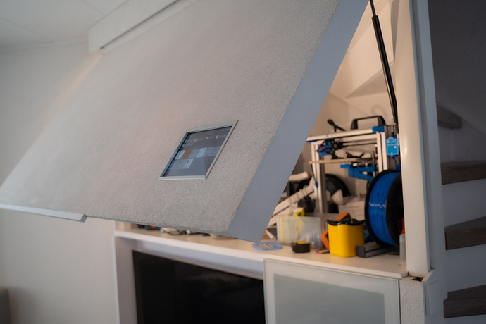

I didn’t made the GUI, these credits goes to the Homy dash / ink developers over here. I only embed it in the wall.
If the question is how I build it in the wall… It was quite easy for me. The living room wall is a large cabinet, so I have easy aces from the back.
I used a router to deepen the hole for the iPad, cut a hole from the front and just hot-glued it in.
But this shouldn’t be complicated to do with a drywall or something.

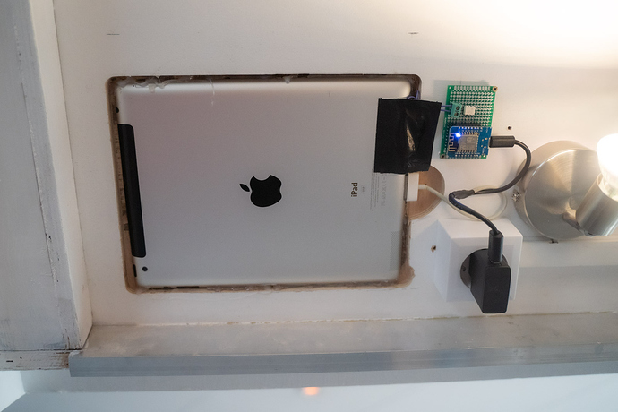

The extra electronics board is a small cheap Wemos D1 mini running Homeyduino. This devices activates/unlocks the iPad reliable. (I soldered a wire on the hall (magnetic) sensor)
The icons do not show for any access method (app\web):

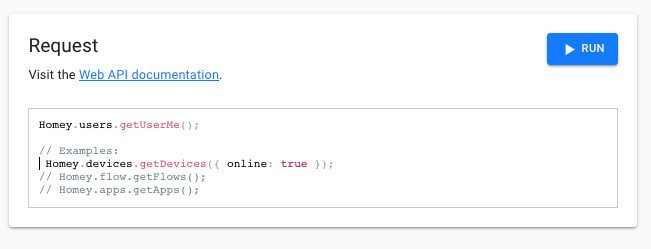

@chinswain can you got to https://developer.athom.com/tools/api-playground and logon (logging on may throw you to a different location, please reload the url after a succesfull logon)
Next uncomment the Homey.devices.getDevices({ online: ture }); line and click RUN
Find one of the devices that is not showing an icon and see if it has an iconObj entry. When it has, click it open and paste a screenshot of it here
We’re looking for something similar to this:
