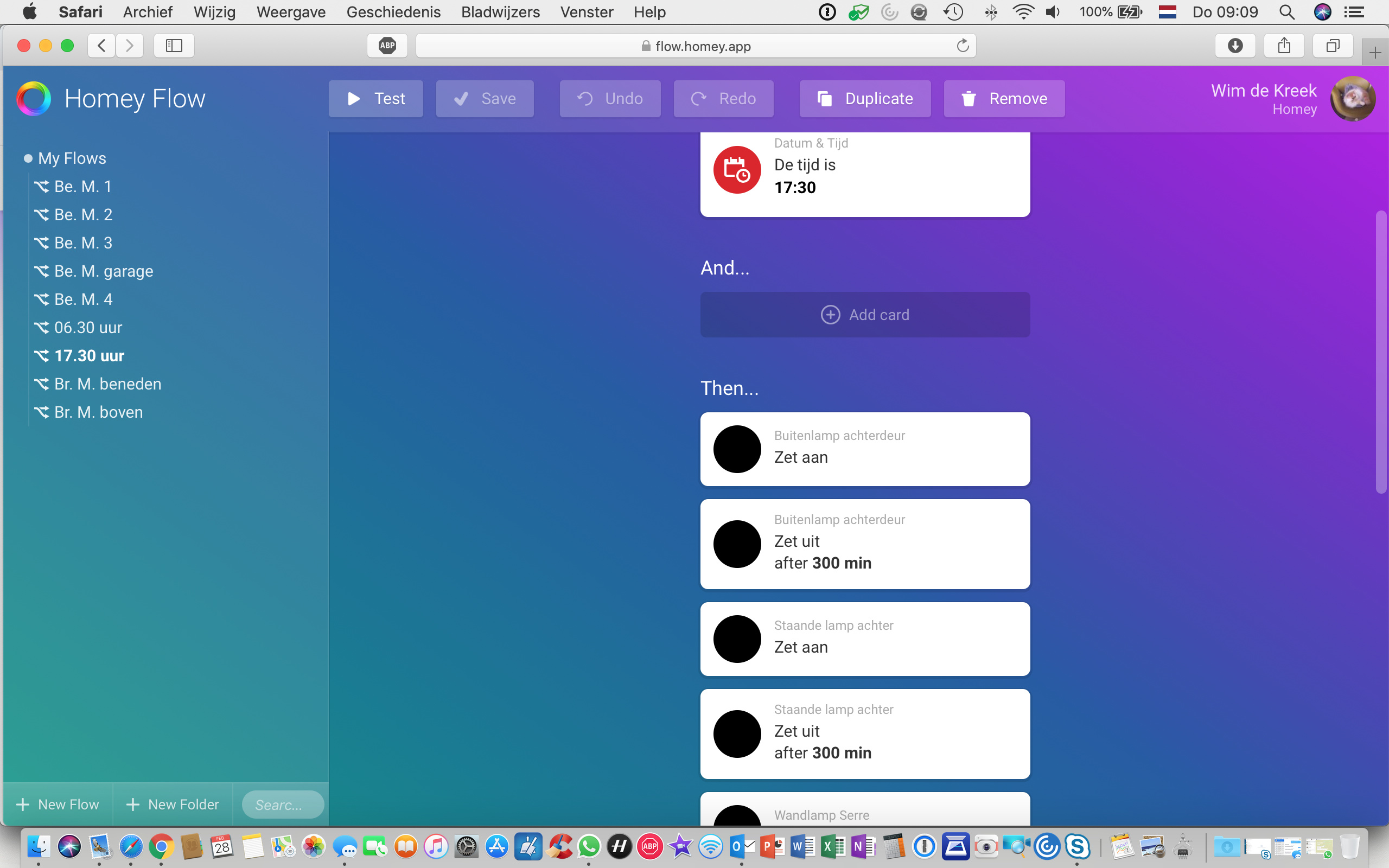

printscreen1; this is the flow for time controlled switch on for 5 hours

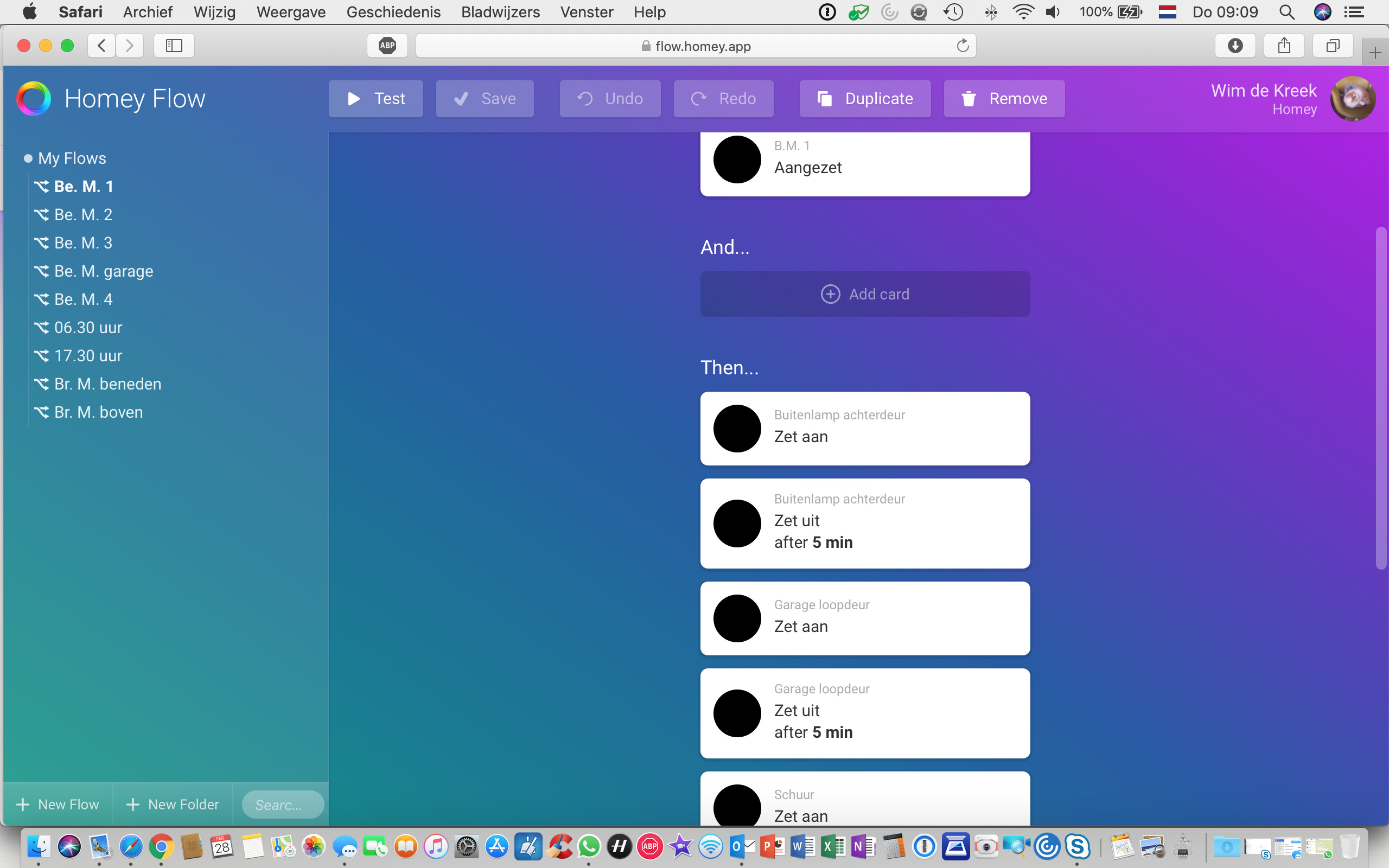

printscreen 2; this is the flow for motion detection with switch the same light for 5 min. after detection
the first flow I would like to be able to choose not switch on, but switch permanently for 300 min or 5 hours.
Hmm, not so easy. Maybe you can build in a time frame in the motion detection flow.
IF motion detected
AND time between 17:30/22:30 (the permanent time window)
THEN switch on x, y, z (and no off for the lights it concerns)
ELSE switch on x, y, z (and off after 5 mins for all lights)
