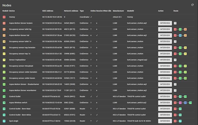

Two weeks ago I have upgraded my homey to stable 5.0.0, updated all apps, and reconnected almost all Tradfri devices through the Ikea Tradfri app (not the gateway app) and let the mesh network build up including aqara sensors.
All was working fine until Thursday evening when suddenly none of the zigbee devices were working anymore. Aqara sensors do not trigger flows and when I try to turn on/off a light in the Homey app I get a notification “Cannot communicate with the device”.
The following remediation actions I have already undertaken in this order:
  • PtP, and waited around 30 minutes before starting up Homey again
  • Changed plug to a more powerful one (5V, 3.1A)
  • Updated firmware to v.5.0.1
  • Reset Homey while keeping the data, and let the mesh network build up over night
The mesh network seems to be built up according to the overview on the developer site.
However, none of the actions helped out and all zigbee devices (Tradfri and Aqara) connected directly to Homey do not work. So I am basically out of ideas.
Tested turning on/off the lights via Homey app that are still connected through the Tradfri Gateway, and these I still can control.
Anybody any other suggestion?
Edit: Interviewing immediately shows an error “Interview failed (error: timed out)”
Also trying to (re-)connect a zigbee device does not work (does not connect)
Edit: Solution can be found in my post below in this thread.
Have you tried to click on Interview and the push the button of the not working device?
Or first push the button on the device to wake it up and then click Interview.
That is how my zigbee shows his route from a couple devices.
Dijker: Edwin_D:
