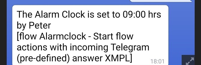

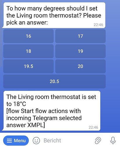

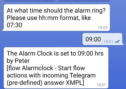

Maybe interesting, I made just this with use of the Telegram app:

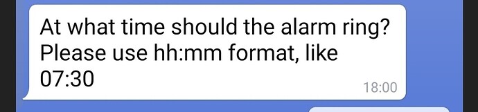

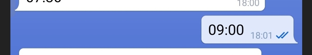

Can you explain more of this part?
Didn’t really understand this one.

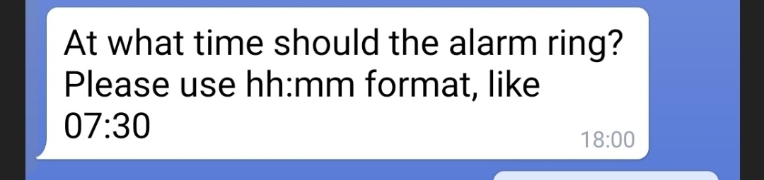

  1. The flow sends a predefined question for the alarm clock alarm time setting to my Tgram, and it shows me what input format it expects
  2. The Tgram app then sends me that question to my phone;
  3. I responded with the desired time in the format I determined in the flow: 09:00

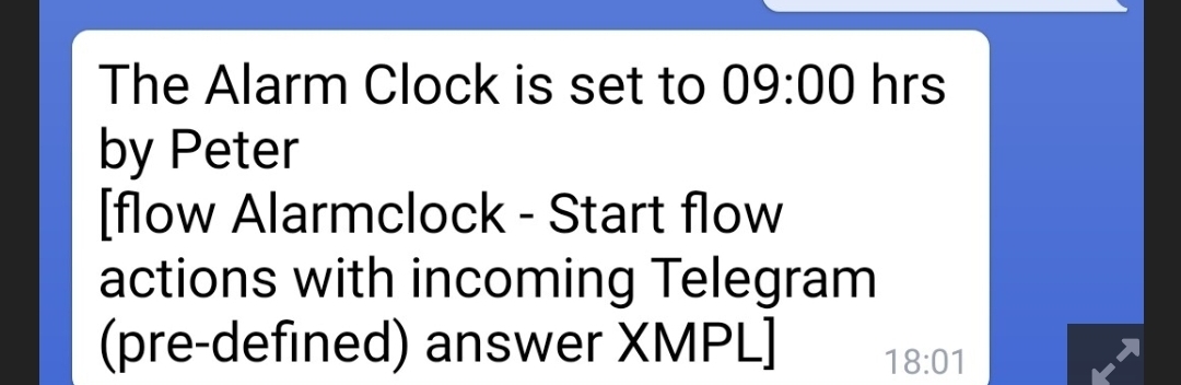

  4. The flow responds with a predefined acknowledgement, with the actual received time value, just for clarity (which is optional of course)
    The line between [ brackets ] is just the very long flow name; I add this info to each notification and log card
Does this make sense, John William?

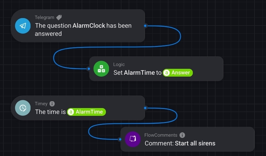

Yes, but how do you do the 09:00 part inside of homey? How does homey understand that you want something to happen at 09:00?

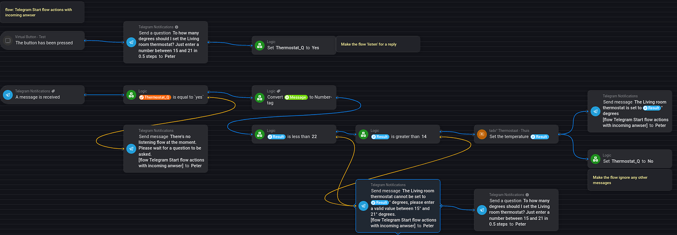

That’s what you’d write with flows…
Basic example:
With the neat “Timey” app you can trigger flows with a time value from a variable.
Ohhh, Thanks!
