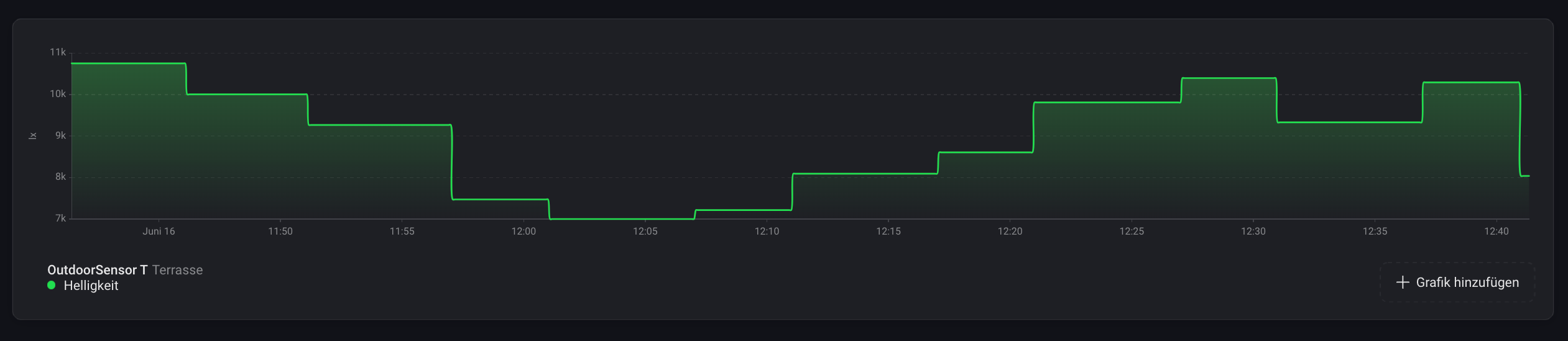

Looking on the Philips Hue Outdoor Motion Sensor (SML002), does the sensor periodically update luminosity value even without detecting movement ? This is eg. disadvantage of Aqara motion sensors

Yes, there is no need to trigger the motion alarm. This is the current interval of my SML002, so about every 5 minutes and I use the Philips Hue, without the bridge app:
The interval can be changed in the device settings:
