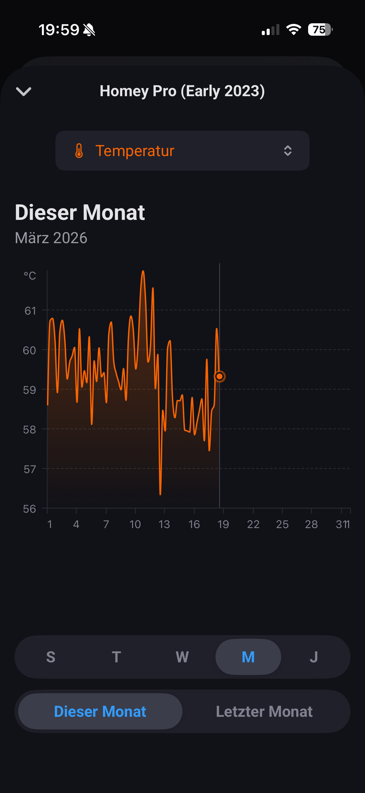

I rule out overheating:
Yes, these are quite usual temperatures.
