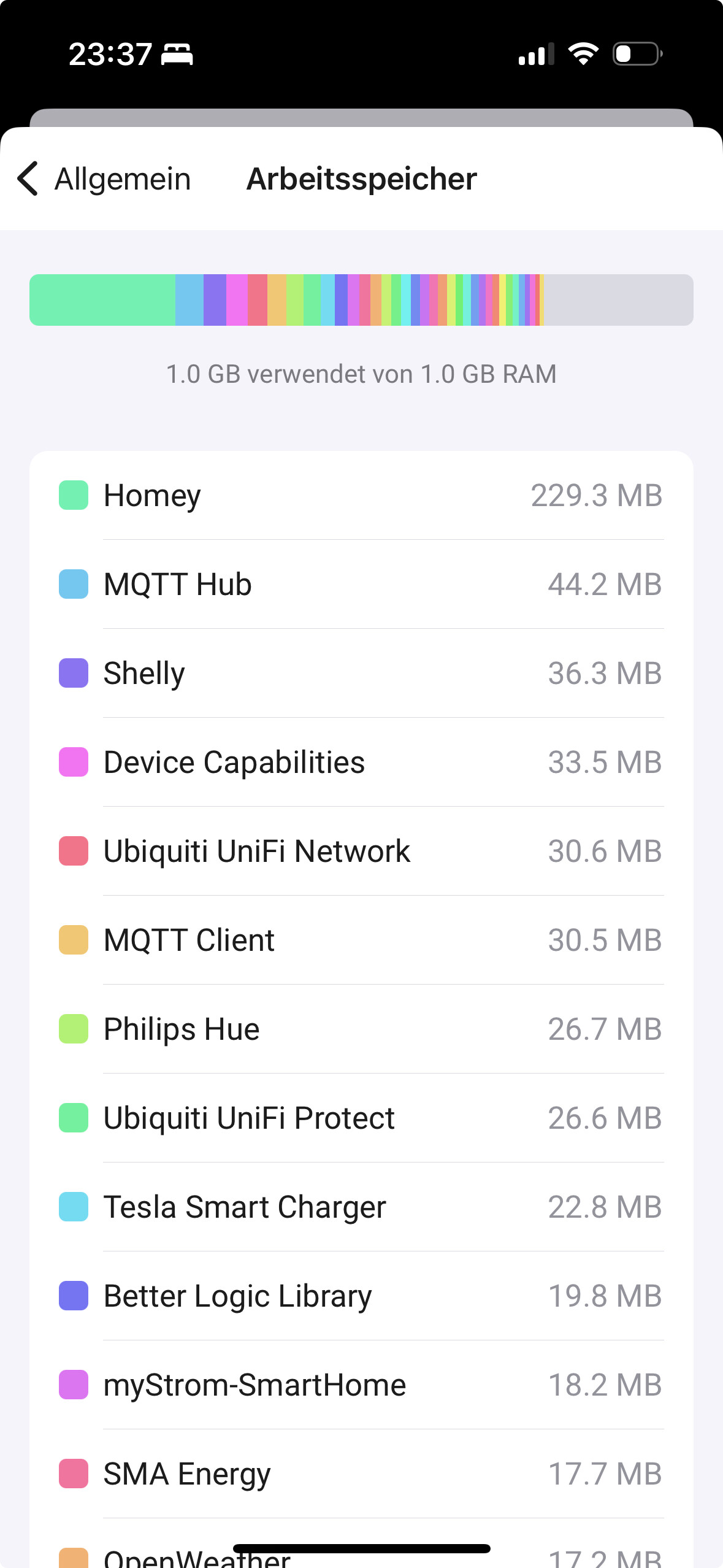

Isn’t Homey out om memory?

(I have also over 40 app’s and i get a screen that Homey can not make a backup.
Only 15,52 MB available of the 1,04 GB + 206,57 MB Swap.
So i have to remove something.)
No Memory issues until now (I don’t know how the get a graph for total mem consumption):
