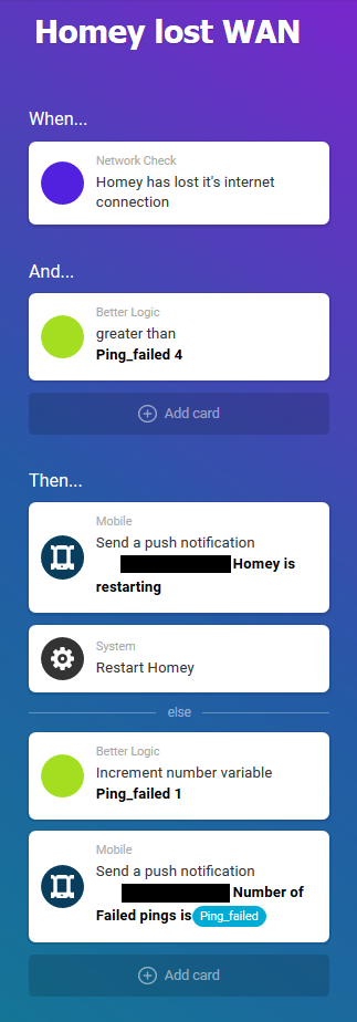

these are screenshots of the previously mentioned flows, that use Network Check, Better Logic (defined variable Ping_failed) and run on Homey v.2.0.5 with power user enabled.
Of course, Mobile push notifications will work only inside LAN, not outside when WAN is lostâŚ

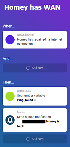

Another flow informs about WAN regaining and zeroes the flag.

According to my information, the Network check card Homey has lost itâs internet connection is triggered after a failed ping to cloud. It might occure every minute.
The card Homey has regained itâs internet connection is triggered only by at least one successful ping following at least one failed ping before. I expect that reboot clears the flag indicating the lost connection therefore it will not trigger the card after reboot.
I use the flow Homey has WAN to inform me about successful ping again after several failed pings.

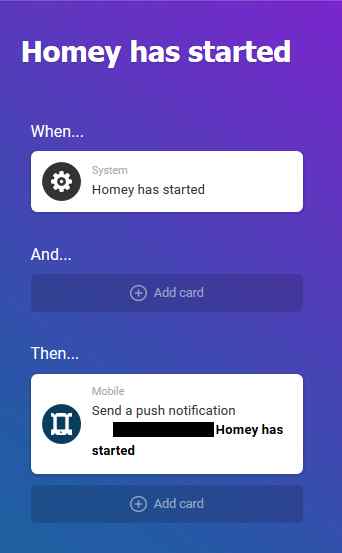

If you want to be informed about the restart of Homey, I would propose you to use system card Homey has started (see the screenshot below) that will inform you right after restart.

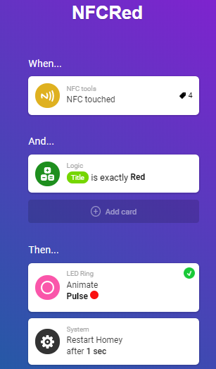

I used a NFC on my Homey v1 for resetting but also a wireless switch as fe a 433 / KAKU could work imho. Have not tested yet with v2 if that also works but I donât see a real problem.

The restart of Homey using the Flow Card works (Triggerd by touching an NFC), also when Homey is disconnected from the internet fe by unplugging the Modem. Local App Worked and Homey Showed Disconnected!.
