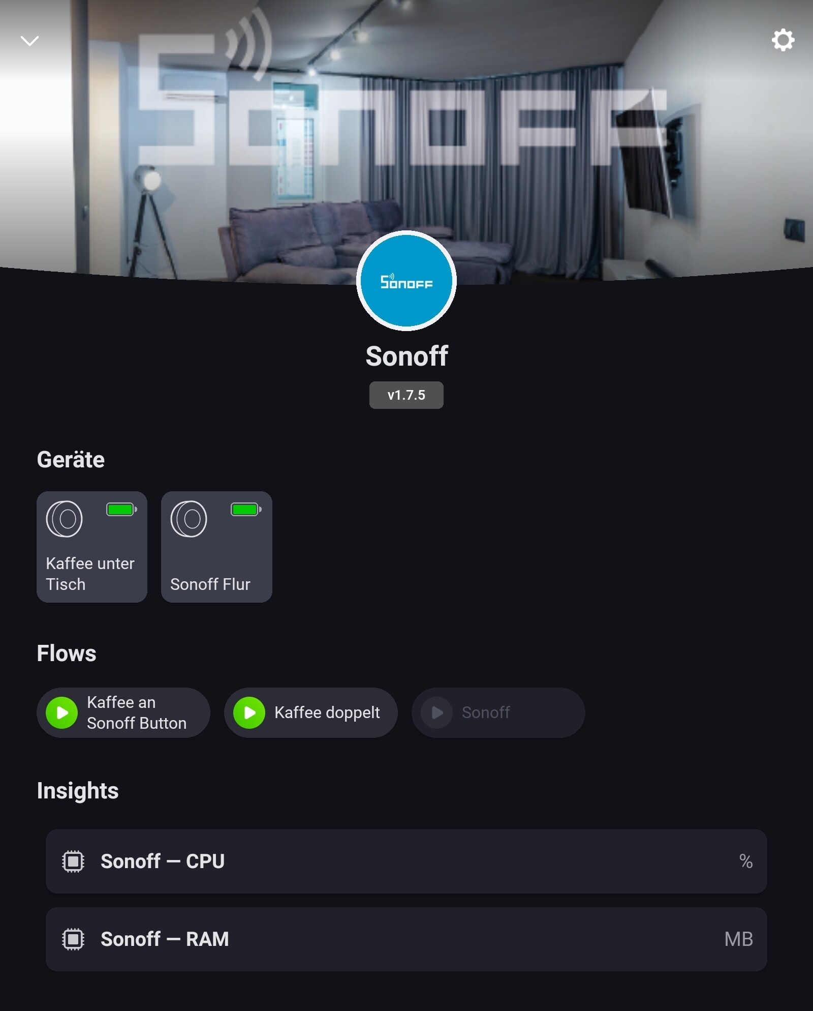

@aitpeter I have two Sonoff SNZB-01P Zigbee devices running on Homey early 26. They were easily added via the Sonoff app. :man_shrugging::thinking:
