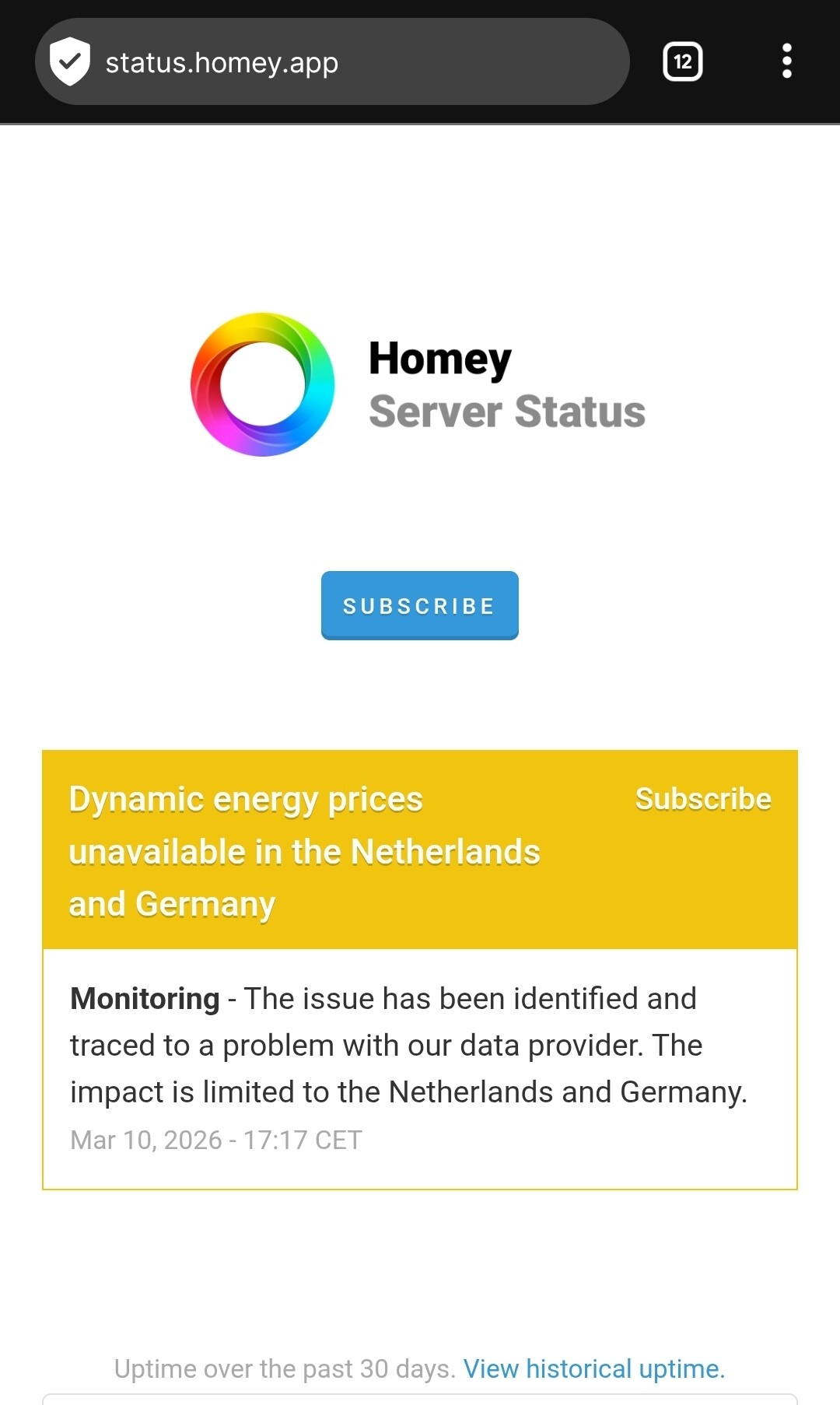

If AI would be actually ‘intelligent’, it would have told you there’s unstability on the price markets for a while now. This makes price driven flows useless atm
Hi Peter, thanks for your reply.
Though I doubt it has anything to do with my question, there is no problem with the flows running at the correct times, in this specific case its even scripted with homeyscript and solar-energy apis.
I live in Sweden, and like I mentioned in my post the price graph is correct, the solar energy is correct and the net energy usage is correct.
