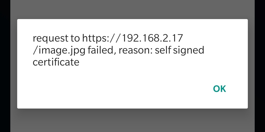

This link was great! Finally was able to apply the hack to my Xiaomi Dafang IP cam.
However, trying to add the camera to Homey results in an error due to the self signed certificate that is used:
I’m using http://root:PASSWORD@IP/image.jpg
Any tips?
Have you found a solution? I have the same issue with my Sannce cam. :frowning:
Same issue with my dafang hack firmware ip cam, only mine says that the “certificate has expired” instead of “self signed”.
Haven’t figured it out and kinda forgot.about it. I have sent Athom a support request, let’s see what they come up with
