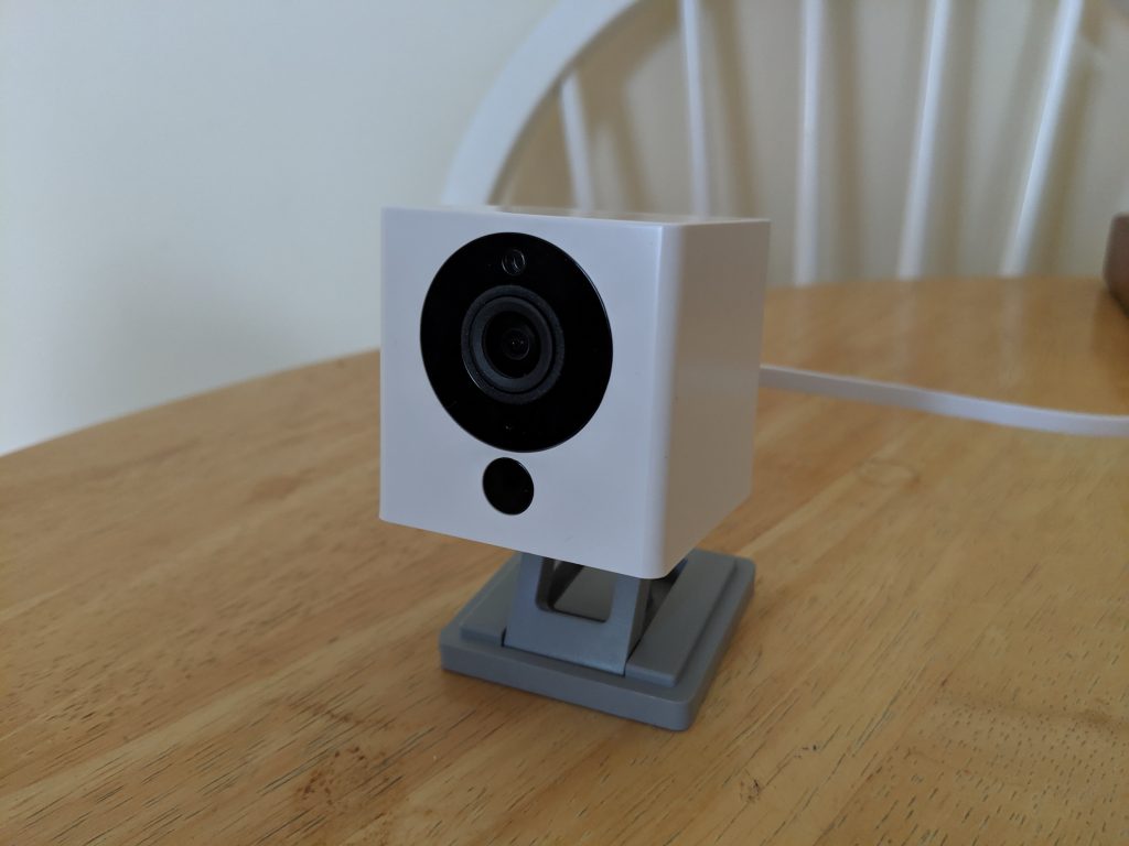

I have a Neos Smartcam, can I add this to Homey?
This is my question, has anyone did this before

I’ve taken a quick look but as far as I can find the camera software doesn’t support anything else then it’s own app. They also seem to be the exact same as Wyze cameras. There is a custom firmware that adds a rtsp stream, wich you might use if you happen to have a synology. Or mayby in an even easier way wich I’m not aware of.
Thanks, has anyone tried this?
