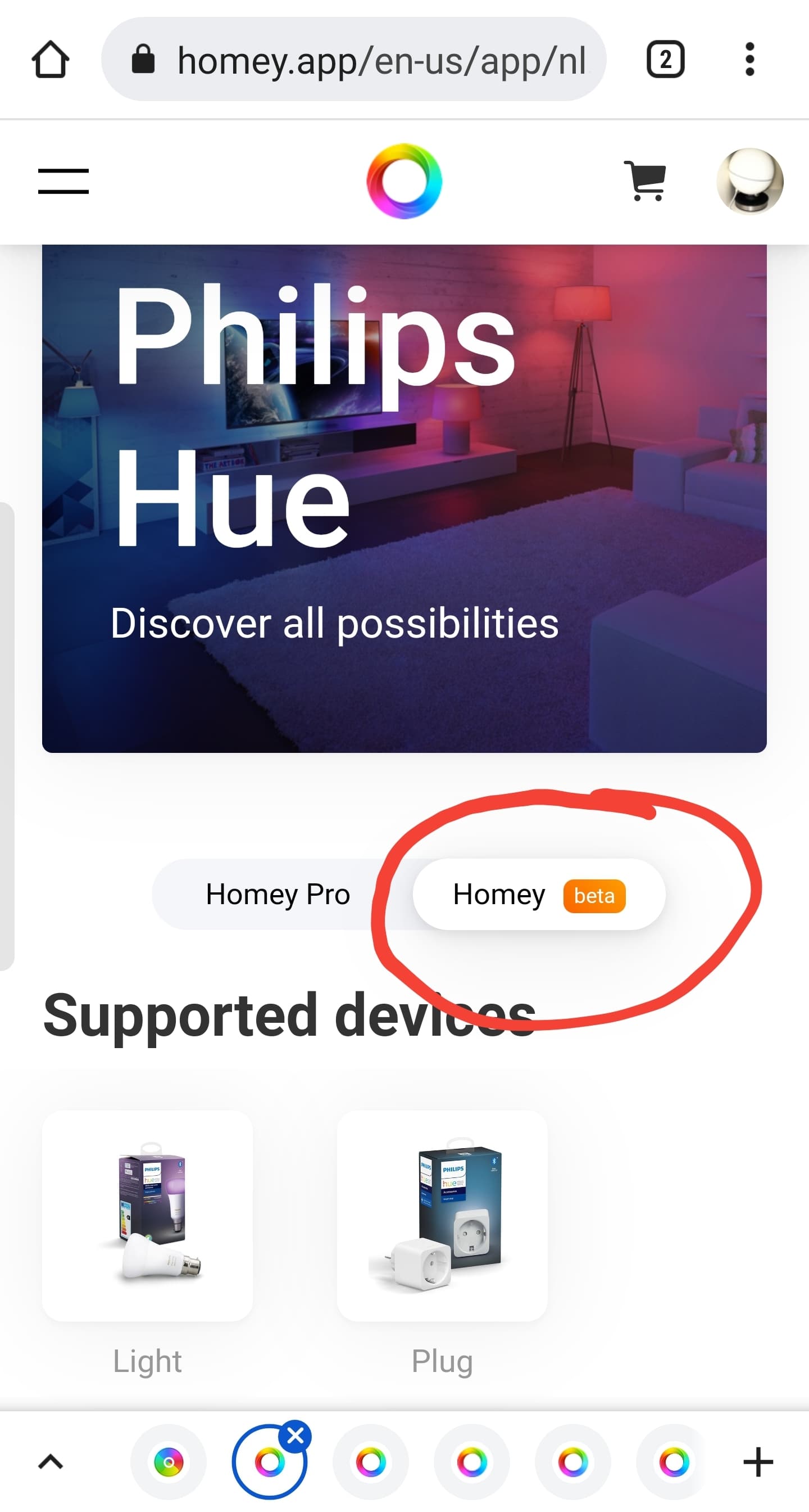

I want to add my phillips motion sensor as well, it is in pairing mode but it wont be found by homey (cloud) is that not working for homey cloud yet? also i can not seem to be able to add my hue bridge to homey (cloud) only my hue bulbs and plug. Can someone in baby language tell me what i could try… fairly new to homey (cloud) have it since today lol
@ app store, by pushing the Homey beta button, you can view which Hue devices are supported at the moment.
With the Hue bridge paired with Homey that is.
Thank you for your fast reply Peter, to bad i can not use my motion sensor with my homey bridge yet, maybe in the future.
