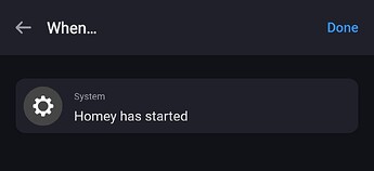

AFAIK the built-in delay stops as soon as Homey restarts, the screen-shotted flow will never start the KNX card.
Your description is right, only he trigger card in the flow example isn’t. :wink:
You’d replace the trigger with the “When” card "Homey has started’. This triggers the flow after the restart.
