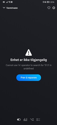

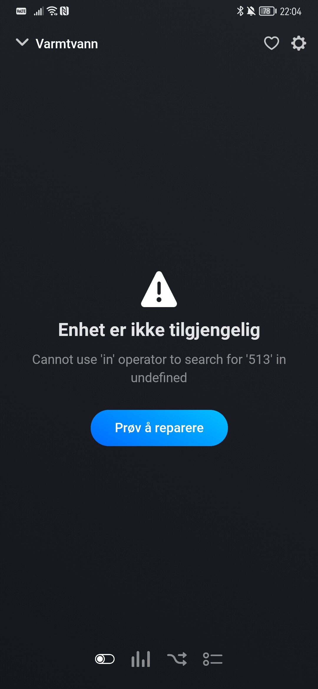

Device in myuplink beta app not working after latest update. Not able to repair or add new device.
I think it should be working again now, please try again :slight_smile:
Yes, works now
