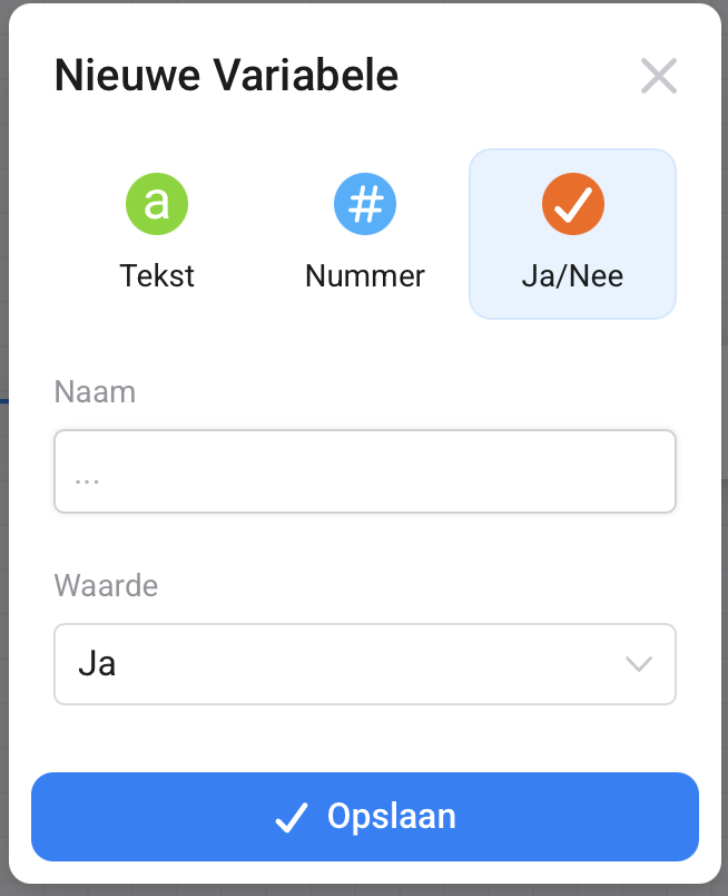

You could also set a boolean after the “came home” card to true. And reset it after 5 minutes (or any timespan you’d like).
Then you can specify one trigger on the sensor and verify the bool value. If true → rest of the flow and set bool value to false (to prevent it from running multiple times in the same timespan).
So basically two seperate flows (in the advanced flow):
  • Richard came home → set boolean to true → delay x minutes → set boolean to false
  • Sensor goes on → AND boolean = true → turn on radio → set boolean to false.
ok thank you ill give that a go
That’s not a silly question. It’s called a yes/no variable in Homey. I’m a programmer that’s why i called it a boolean :nerd_face:
Screenshot is Dutch, but i think you will understand :+1:
