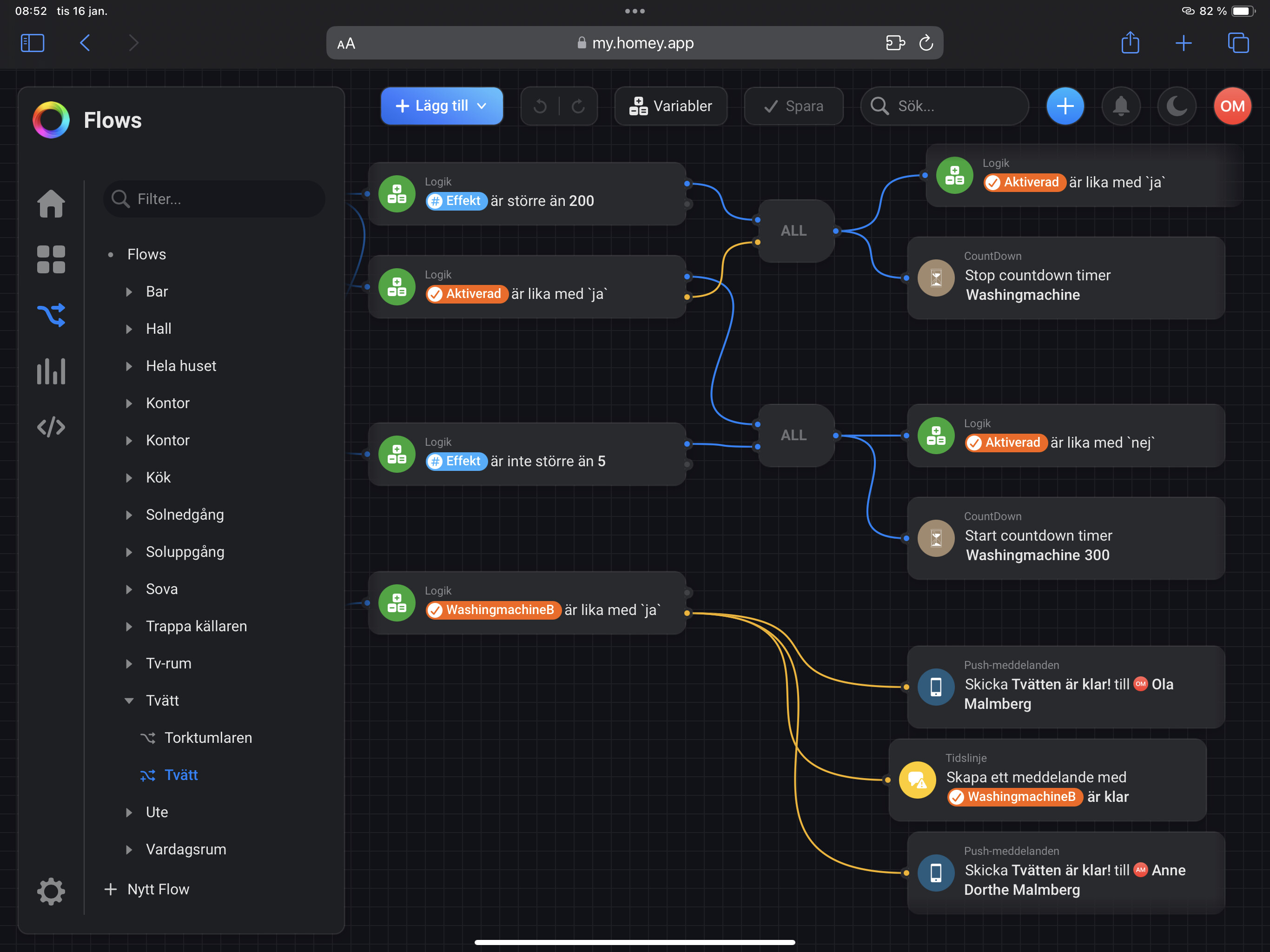

Hello I would appreciate some help with this flow
It works but it gives notifications regardless if the machine is running or not. The are a bit random but comes in groups of 3-4 withe 4-5 minutes apart then it takes some time an hour or so then another 3-4.
When I wash it works great.
The rightmost card in second screenshot “Aktiverad är lika med ja” does not set the variable “aktiverad” to “ja”, it only checks whether it is “ja” or not.
Use “then” cards to change a variable, not “and”.
Instead of of using “Effekt är inte större än 5”, use “Effekt är mindre än 5”.
