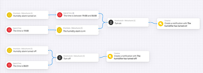

Hi @Jari_Peuhkurinen ,
Most important is that the first card When… is only a trigger that fires at an incident. Then the flow is works off and stops. It starts only again if the next incident occurs, in your case - the alarm changes from off to on.
Usually you should avoid busy-wait, but in some cases it might be useful or an easy start.
yellow lines after the And… cards mean in case of NO
That is not anything I would suggest. But it is more or less how you looked on the problem - and it would work.
Then you could check how others solve similar problems and which solution you like the best.
You can also add a condition to start the humidifier at 19:00 if the low humidity alarm has already been triggered before 19:00.
Thank you. Now I understand the basic structure of the advanced flow. I was unsure if there can be multiple triggers in one flow and how to combine them, but your flow made it clear. Thank you so much. Amazing community!
Thank you. This looks like something I had in mind in the beginning. Trying to combine everything into one. I must experiment with this one too :slight_smile:
