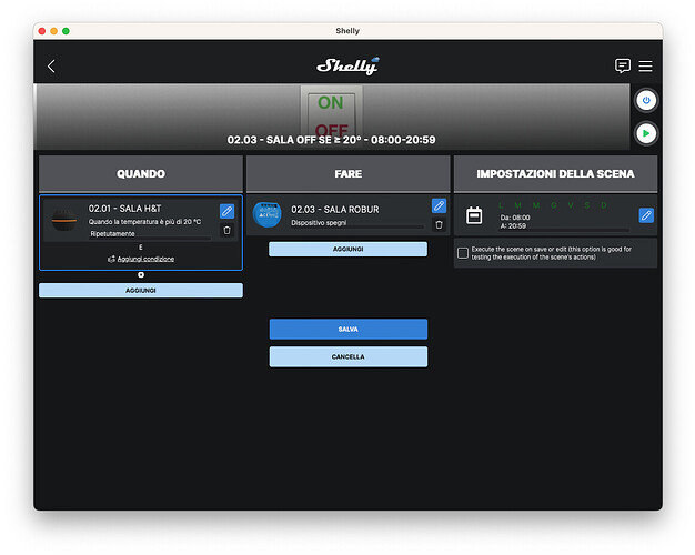

My goal is to replicate and implement Scenes written today in the Shelly App (Mac, iPhone and iPad); here is an example:

The difficult part comes with these other two “Scenes”:
– Turns on if:
– Turn off if:
In these two cases the temperature values of the “Shelly H&T” intervene.
This is why – for example – I am interested in detecting the values of Humidity and Temperature.

This is very simple flow in homey:
Turn on:
Trigger: temperature H&T changed
And: temperature H&T < 20 (use logic card)
And: time between 8:00 and 20:59
Then: Turn on switch SALA Robur
Same setup for turn off
You have a Homey Pro so there’s no cloud involved in operating the Shelly stuff. If you have decent WiFi coverage the switches very rarely miss an operation.
And that is why those values are readily available without the need for any additional cards.
