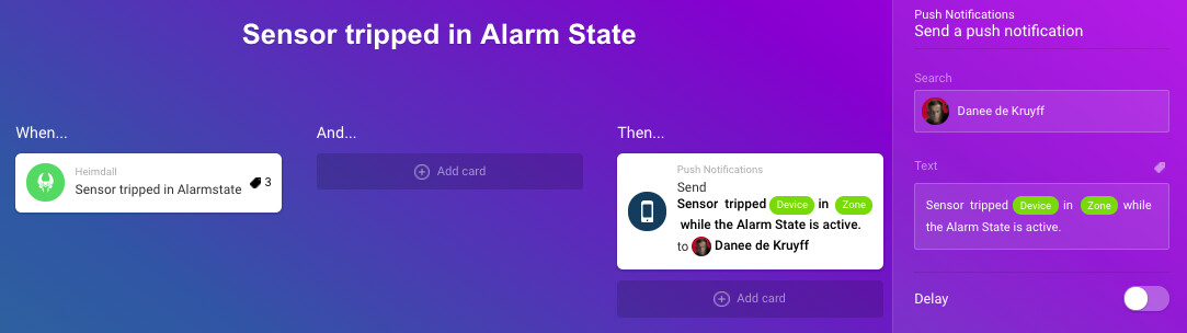

Yes that’s possible, you can use the resolutions provided by @Ricardo_Nunes and @Rocodamelshekima but you could also use Heimdalls builtin trigger card for that purpose:
That card has 3 tags, the Device, it’s Zone and the devices State (motion or open)
thnx, overlooked that option :ok_hand:, implemented it directly and works like a charm!
