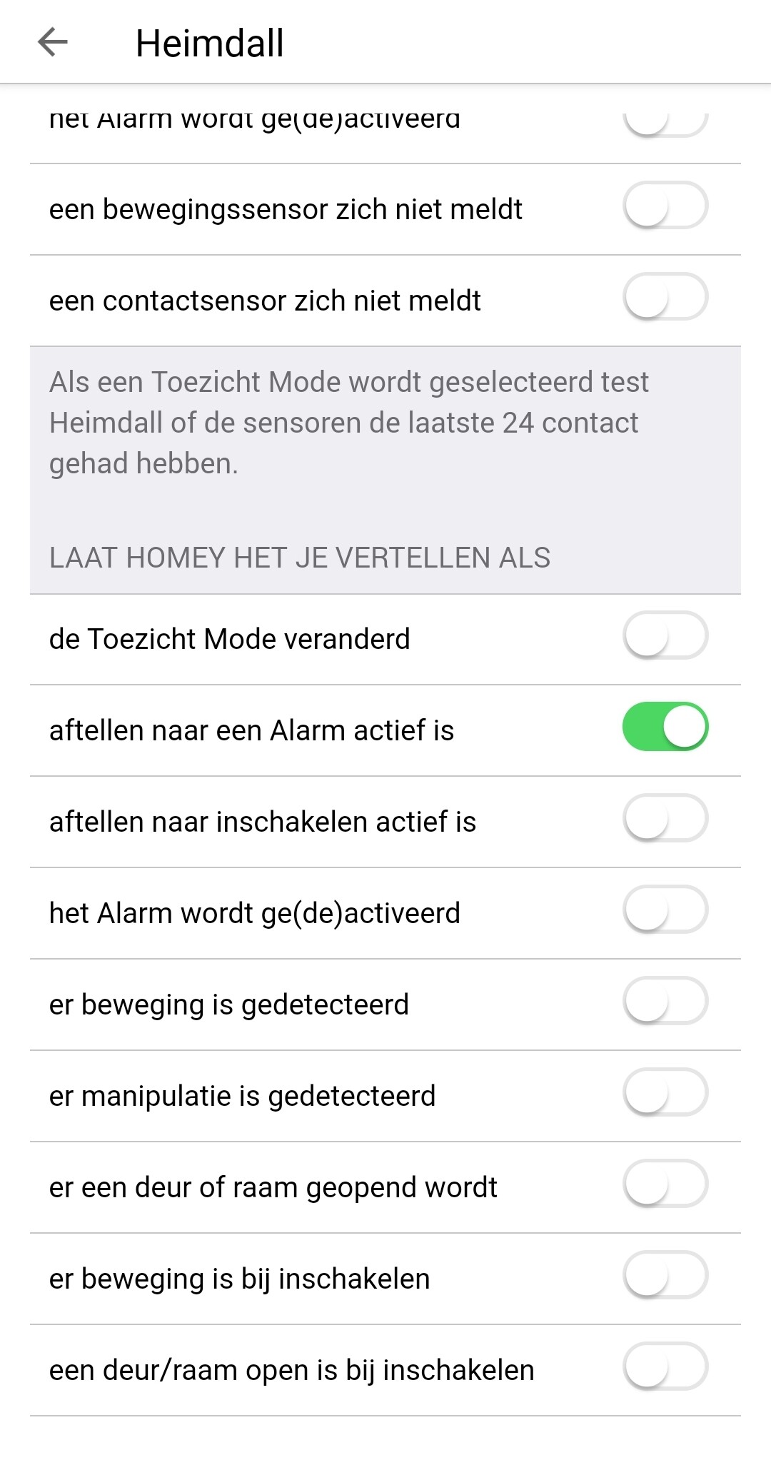

Now that I check these settings:
For the push messages to my phone; what should I disable?
“Let Homey tell me” is disabled already. But suppose this is a voice message from the speaker of Homey.
See my settings below…
What kind of push message do you get, did you check “woning” in your iOS device
Otherwise its a flow that sends a notification i think

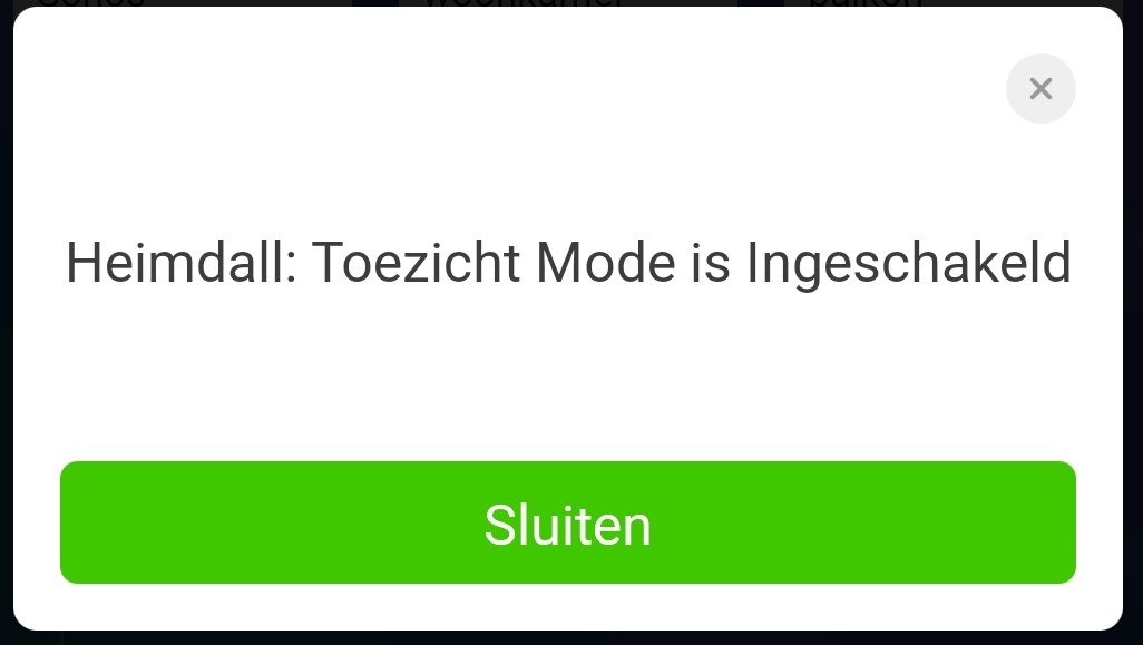

The Homey app sends a push message that Heimdalls surveilance mode is en-/disabled:
Check overhere
I did, but that would disable all push messages from Heimdall if I am correct… (?)
When there is an alarm, then I would need to get a push message of course.
Just want to disable messages for enabling and disabling surveillance mode…
Disable it and make a flow for the alarm push notification
