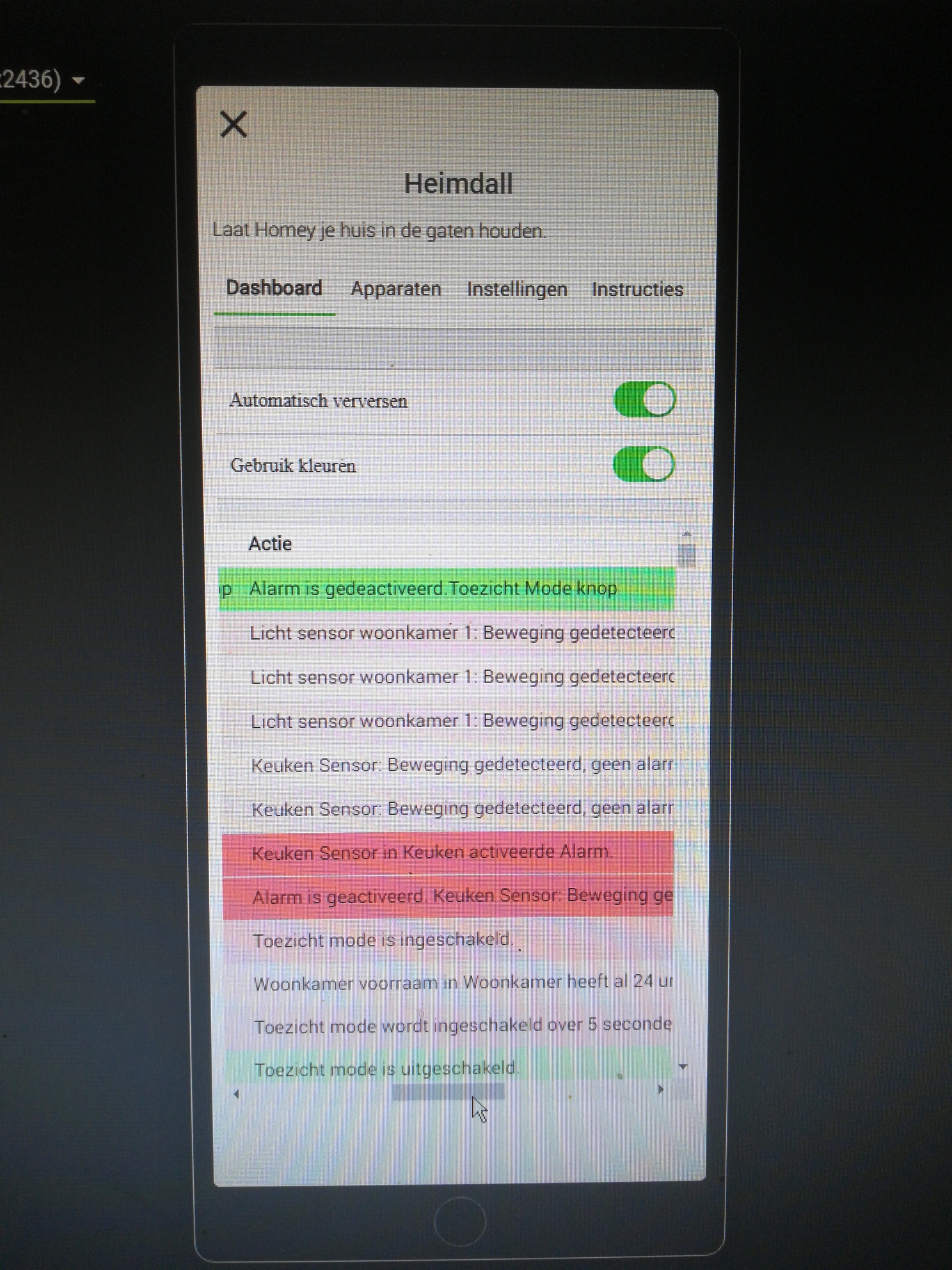

Could you do some extra tests with that flow? Different devices, use the add and remove cards, use the cards for the partial mode etc.
Check the Full (and Partial) status on a device on the Settings tab in the Devices tab before and after running the flow. Do remember to close and open the settings page each time. There is no need to change the Surveillance Mode.

I have don a quick test… On the setting page the sensor turn on and off with my test flows… I’m afraid the fault is on my side and not in the app .
When i have some more time i gonne check my flows . :crazy_face:

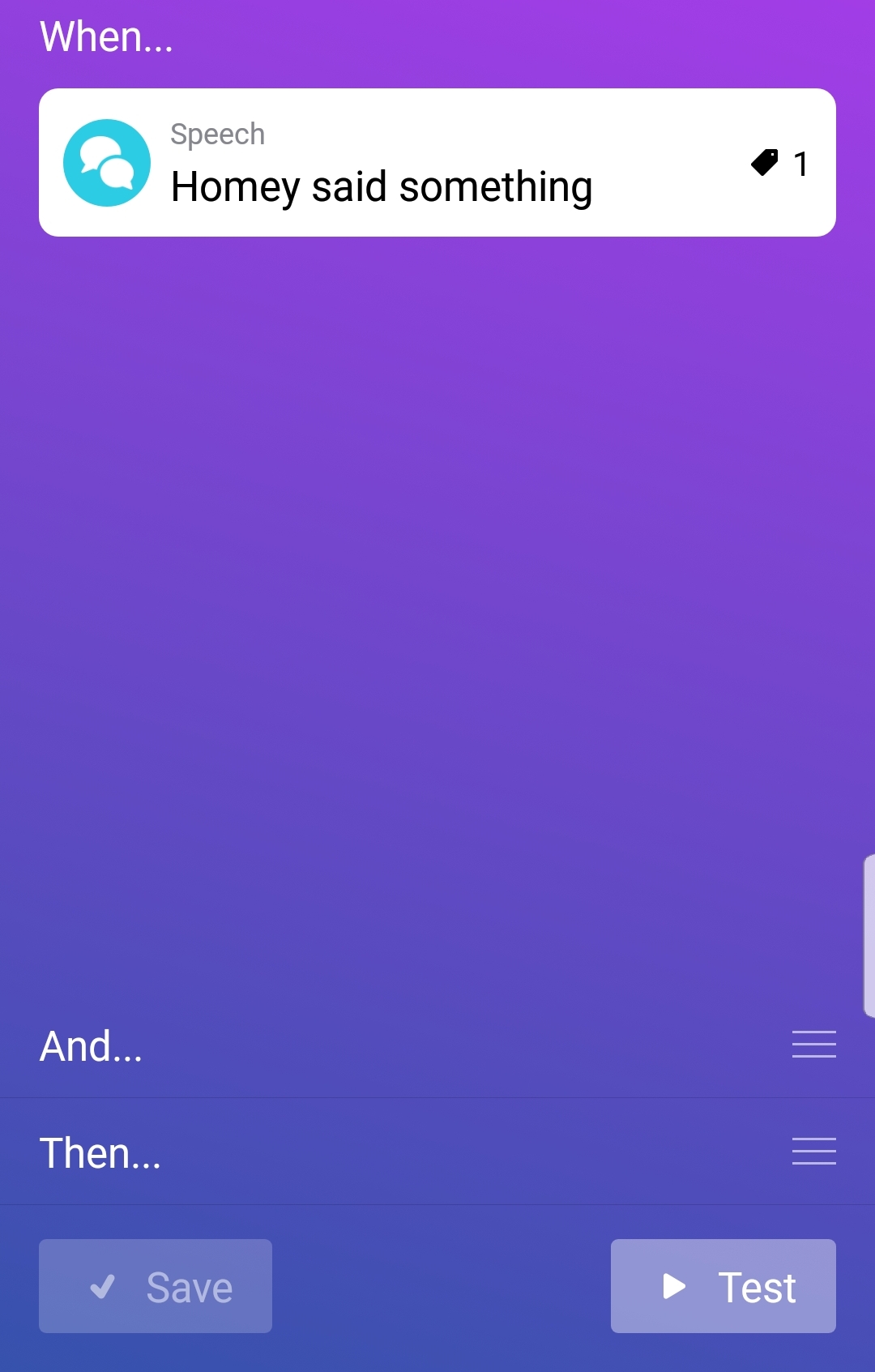

Hi @Danny_Mertens, I do something similar, but for all speech by Homey, not just Heimdall. There is a native ‘when’ card “Homey said something” under “Speech” and a tag “text”, which contains the spoken text. This you can use to TTS to any other speaker.

Ok I was completely not aware about this, thanks going to look in to this!
Thanks for chipping in @molensky that should do the trick and is a better general solution than me building this into Heimdall.
No problem, just let me know if you get it working or need some assistance.

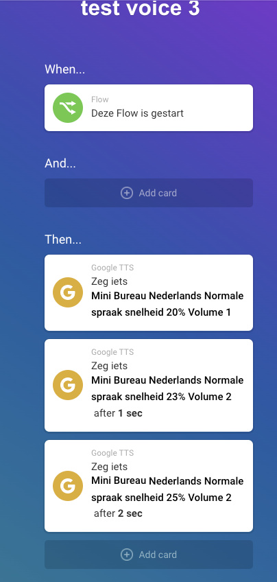

What I have done, I created a flow where i put the voice output to a variable, nice find @molensky I see possibilities here, but I’m not able to get it working for Heimdall yet
I see the variable nicely updating with the voice values even the countdown
The problem I have now is sending this to a Google mini for instance, if I do this only the last text, or not even that is said, so to get message for about what windows, doors are open, or the countdown… this does not seem to work
Also without using a variable for this does not work
I think going with the tags is still the best option, so for instance when windows, doos are open put that to a tag so we can read this, surveillance mode in another tag and so on…
The problem is still the countdown then, I even tried to create a flow where I do this manual but also that does not seem to work very reliable to be honest, anyone an idea how we can do this?
Off course can also be something stupid from my side, did you use this for Heimdall @molensky, if so please can you share your flows?

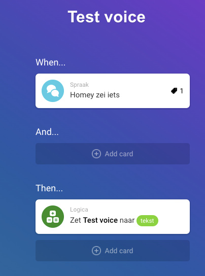

You can also make a flow like this to see in the timeline what Homey said:
When using the built-in function the text should read: Waarschuwing, sensor [naam] is geopend

Hi @DaneedeKruyff my apologies for the late reply, could not in-depth test before, but no for me it really does not work.
I only hear parts of the message on my Nest mini, hub and the countdown is completely messed up to be honest.
So maybe I’m doing something wrong, or it’s my infrastructure, would be strange to be honest because I have a complete flawless working Unify network and no issues at all with other things, but you never know off course but for me there is just to much delay to use this reliable
I use the option now for other things like update values in a variable for instance, works great for this, thanks for this @molensky but for Heimdall it’s not directly an option for me I’m afraid.
