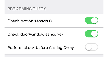

How can I exclude the motion sensors from the apps settings.
This can be done with the Pre-arming check settings:
I do see your flows now; when you use the Check status of all sensors (Ćberprüfe Status aller Sensoren) flow card it will do just that, it will check all sensors regardless the Pre-arming check settings and the Surveillance Mode you are selecting.
That card is added as an extra function to check all your sensors, the Pre-arming check is always executed when a Surveillance Mode is set, there is no need to invoke it seperatly.
The Sensor active at Status Check. (Sensor aktiv bei Status Ćberprüfing.) flow card is to be used with the Check status of all sensors (Ćberprüfe Status aller Sensoren) but I think thatās also not the one you want in your case.
The Sensor active at arming (Sensor aktiv bei Einschaltung.) is the flow card you want to be using. That card is invoked at the Pre-arming check.
