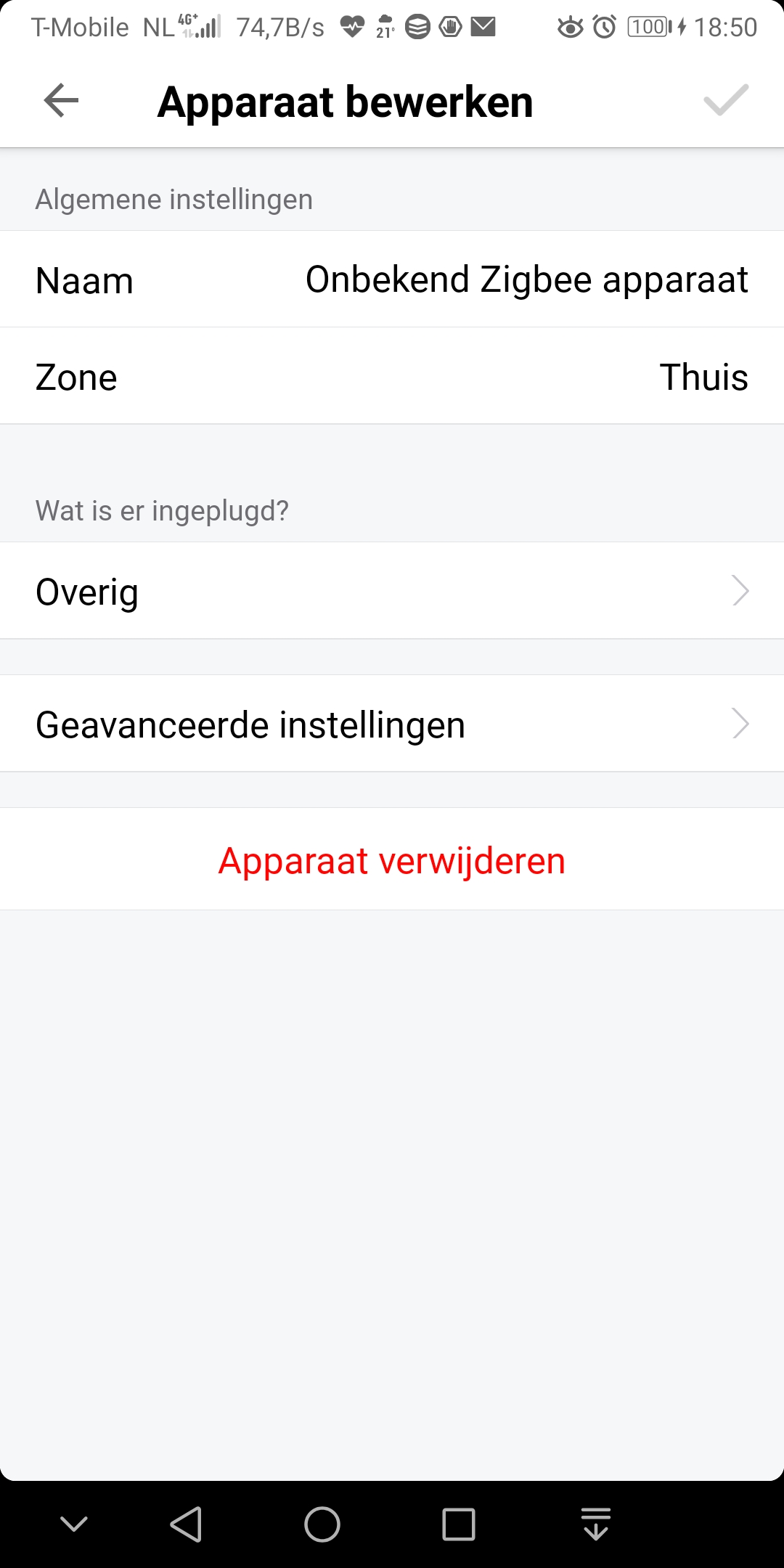

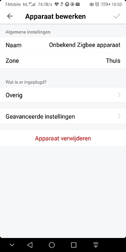

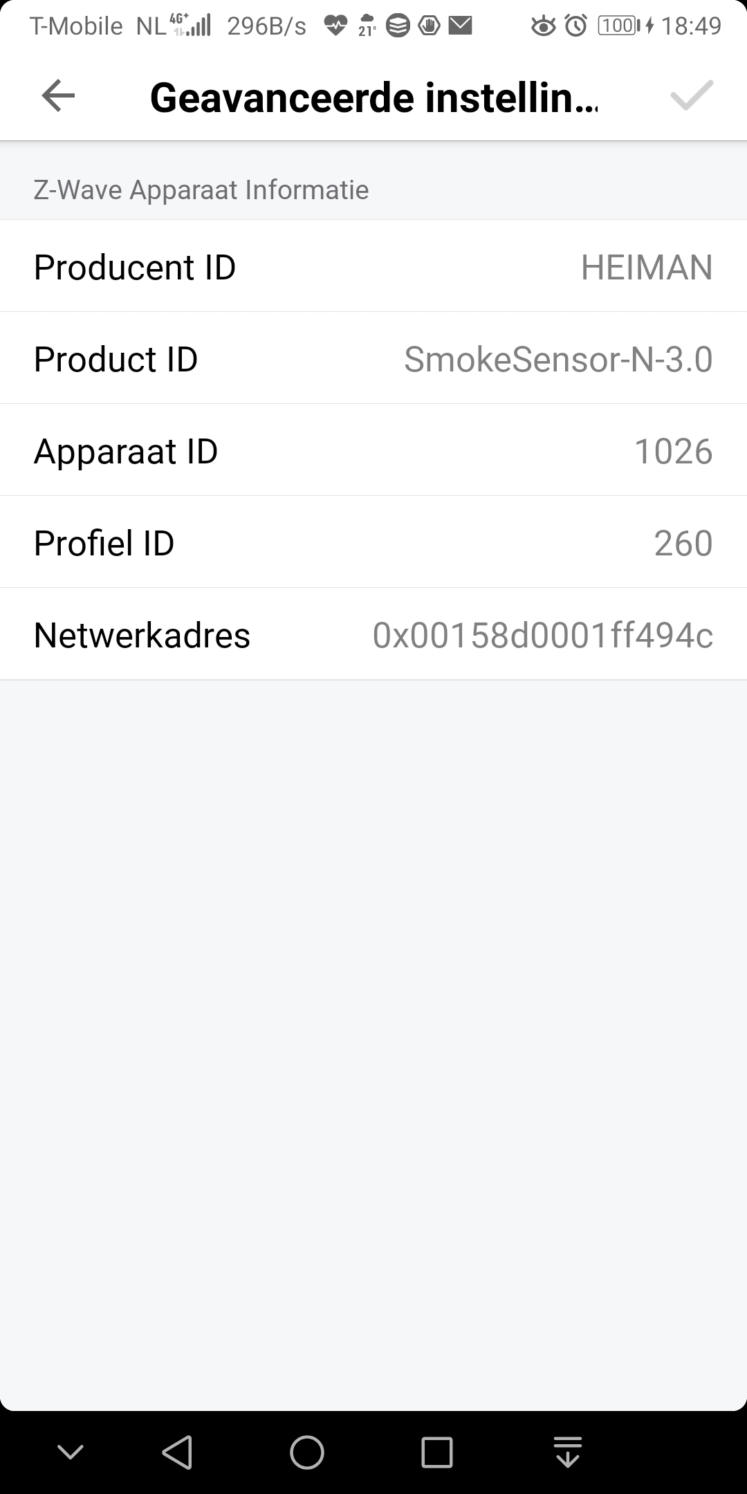

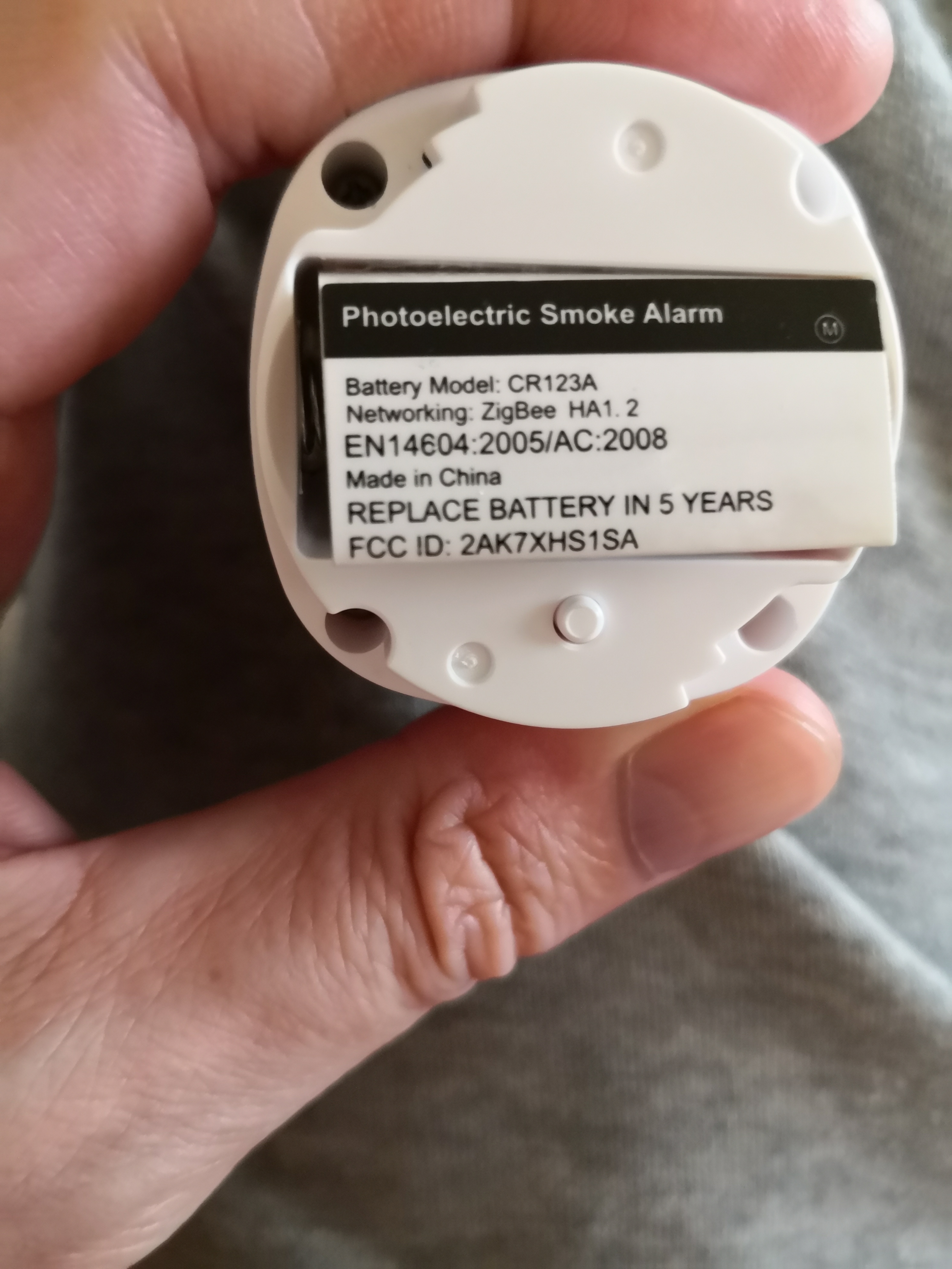

Strange I had to attach it as homey zigbee and it says Heiman zwave
I don’t see z-wave anywhere on your pictures?, only zigbee
That is a bug in the Homey app… also visible for other Zigbee devices.
Please report it as an issue to Athom
