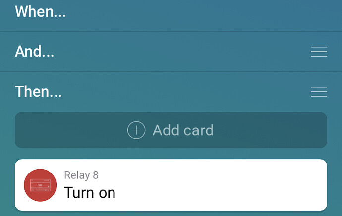

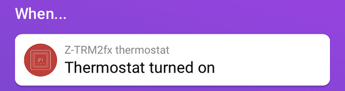

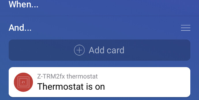

Hi to use the waterborne heating i ned to link a relay in the trm2fx with z water. Like this in fibaro https://m.youtube.com/watch?v=GwuYtsjG0Kc
@Nerohan_Selvendran let’s create another entry into the FAQ…
Let me know if this is helpfull or if you still have questions to create the right setup.
