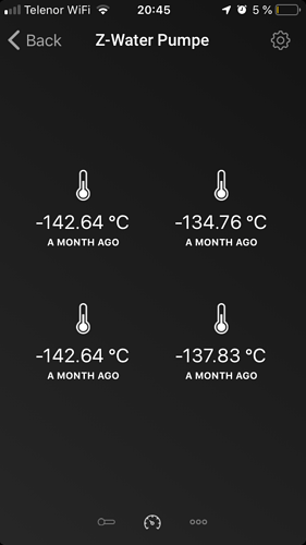

I have a problem with my z-water unit.
I just bougth two 10k ntc sensors and connected them to sensor input 3 and 4, but hey do not give any changes to the temperatures that i can see in “relay 1”
I have standard z-water, no updates.

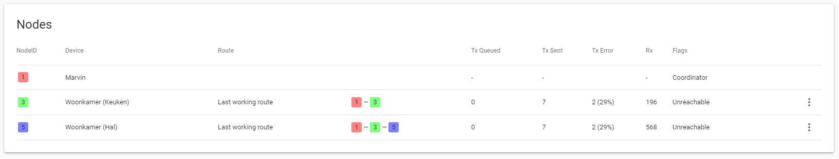

I hope anyone can help me over here! I have (currently) 3 Heat-it TRM2(fx) / TF 056 thermostats, but they keep failing in the network. I followed all the instructions:

After all this, all looks perfectly fine. All the thermostats remain “reachable” in the network and the “RX” from all devices are reasonable. And when I “test” them through the developer pages all seems fine still.
However, from the first time I adjust a temperature, all devices go completly nuts. The “RX” ramp up very fast (from the untouched state of about 50 per day to 10.000 per day) and it’s very hard to set the temp manually, let alone through flows.

Which app version are you using?
Are the thermostats included unsecure (check advanced settings)?
What is the distance between the thermostats and Homey; are there other routing devices (mains powered Z-wave) in between?
Thanks for the super-quick reply!
App version 2.4.2 (Homey version 4.0), thermostats are incuded unsecure (it says “x” at secure).
The first thermostat is about 4 meters from the Homey, the second is about 7 meters and the third is 1 floor up on the exact same spot of the Homey. Those are the only 3 Z-wave devices in the network (currently).
Can you do me a favour and
  1. Send me a log (1-2 hours) of the Z-wave developer tools filtered on Node[x with x the node that is creating the large amount of communication?
  2. Send me a diagnostics report from the app and mention the ID here.
  3. Paste a screenshot of your Node overview with the RX / TX values (after creating the logs)
For this device, which firmware is it running?
