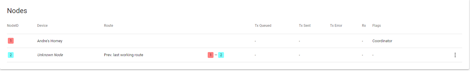

I tried to reset thermostats several times and also resetting Z-wave network without success. I can see in developer that they are visible but still unknown.

I could only see the node in z-wave network. On the device page i can’t see anything. Later today I can try to include all thermostats on more time, since i kinda gave up last night.

I can see on the developer page that its added to the network as unknown.

the one that gave me trobles was the one that had almost no communcation , tx/rx count . the one that was easy to exclude and reinclude had a high number. it also had “last working route” noted , while the other one was of the “unknown” kind. (im referring to my screenshot further up in this thread.)

the screenshot shows node ID.
node id 66 and 67 are ztrm2fx installed unsecure with the new beta.
