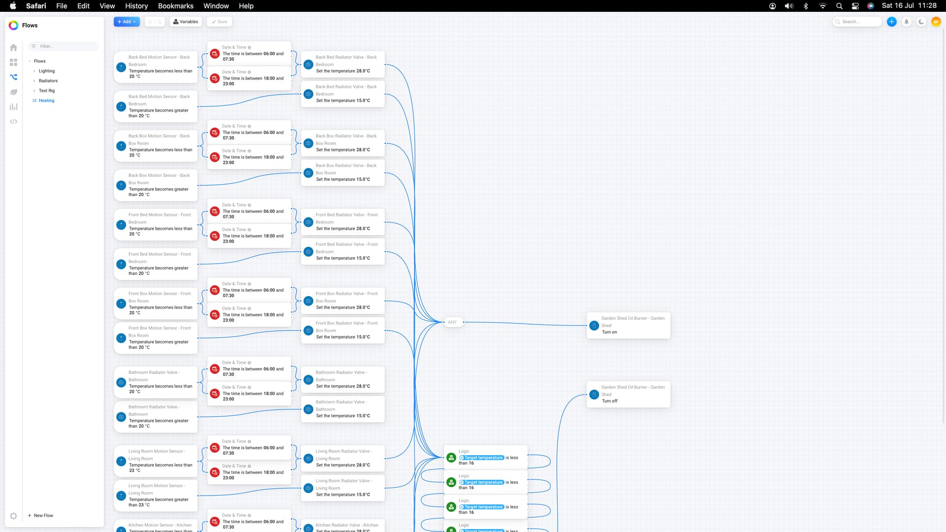

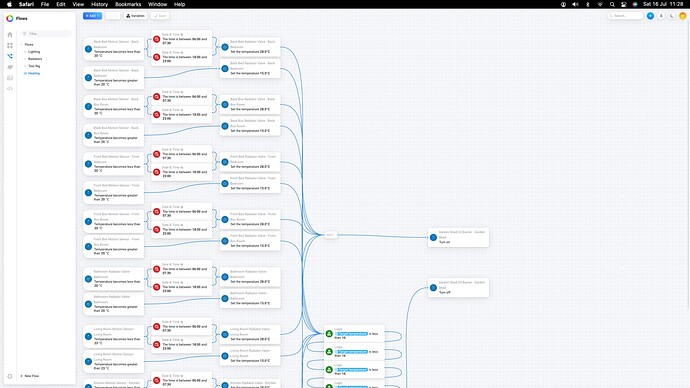

Hi Jan
This is what I done I’m sure it can be simplified
Two screenshots needed So just take up from where needed on second screenshot
Damo
