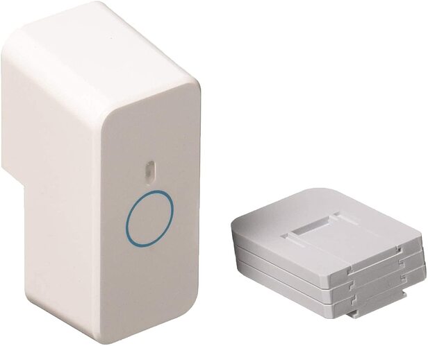

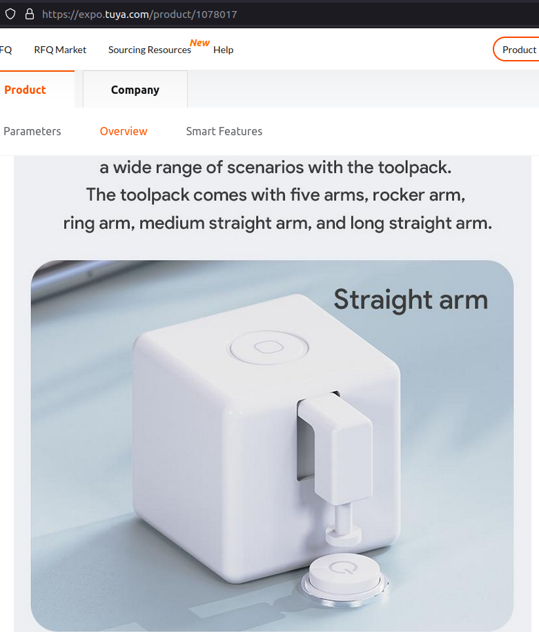

Doesn’t it come with several arms?
Not promoting Tuya here :crazy_face:, but it seems to come with a ‘long’ straight arm as well
The Switchbot presses sideways and comes only a few millimetres below the housing. There are no different arms.
Turn-On-Laptop-Remotely-Switchbot
The switchbot is designed… poorly.
@Peter_Kawa : your second picture is the Tuya ‘Fingerbot’. Better design, but to my knowledge not supported (yet?)
No need for Tuya wifi devices to be supported, by using a little more effort:
You can use tap-to-run scenes to control it, also you can use Raw commands. Mixed or instead.
Raw command have the advantage it talks both ways.
I’m using four fingerbots in my house. I bought a cheap bluetooth/ zigbee gateway supported by Tuya. Add the fingerbots to the Tuya app, connected the Tuya app to the cloud, and can read out these fingerbots in Homey as a regular buton (device).
