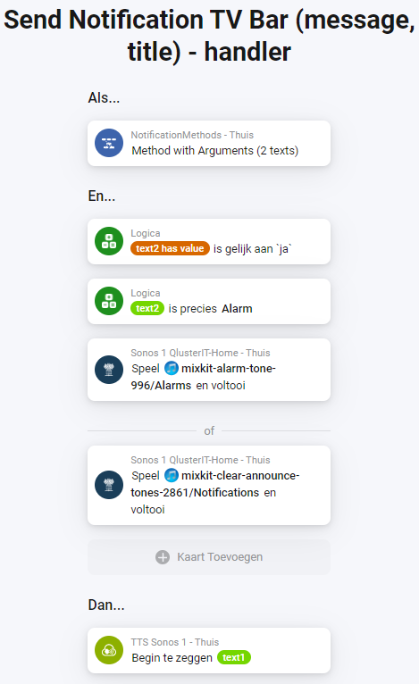

Example if-or-finally
Example another if-or-finally
If text2 has value and text2 is ‘Alarm’, then play Alarm-tone, else plays a Notification-tone.
Finally, start the Speech.

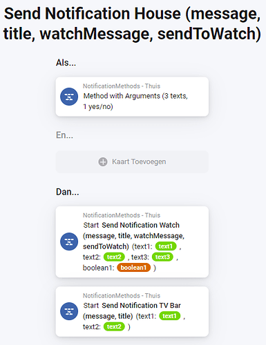

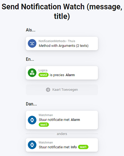

Example for a Notification / P.A. System
This example creates multiple Methods on my Notification Methods (Flows), which allow me to Send Notifications to my Sonos (TV) PlayBar or my SmartWatch.
Either only to my Watch, or only my TV Bar, or to both, or to both with special options like a title being “Alarm”.
Al actions-to-execute and conditions-to-check are programmed in a single end “method” (flow) for each device i want to notify, giving great flexability on how to handle end-stuff without having to repeat those actions in various starting flows.
Instead of a Watch you could ofcourse use the (Homey Notifications to) Phone.
I can activate any of the Methods below, and it will execute exactly what I have programmed in those Methods.
