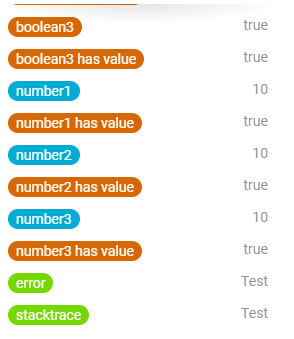

Tokens are available, based on order and type:
