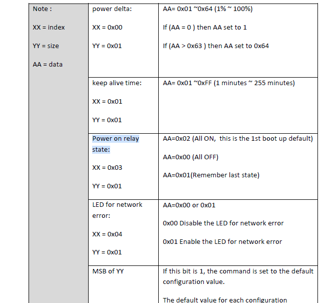

I can’t say I understand/can interpret that information (what does XX mean, YY? etc.) but… since both these ‘parameters’ are already in my list of 5 I can sort of deduce what they meant by that. Thanks for looking into it for me… if anyone finds parameters 6 and up somewhere, please post! Thanks all and esp. JP!
Gateway sends 0x70,0x04,0xXX,0xYY,0xAA this is where XX and AA is used for.
All the information you asked for, is in this document. Start reading and interpreting.
The numbers you mention, are numbers from Athom, not from (the)-(this) doc, Read the descriptions in this doc.
Thank you JP… I had had another look at it and came to the conclusion that as far as ‘configuration’ options go (parameters), this document does mention the same 5 I posted above (which incidentally I picked up from the Homeseer community years ago). Maybe some other settings are available in Homey but I will have a look at them as soon as I actually have a Homey available myself. So far so good (or perhaps not, who is to say) but thanks for pointing to the document again. (I wasn’t used to parameters being described like that, now I’m better clued on. Some stuff in there feels more useful for programmers than end user (me). But Thanks!). I’m quite happy to leave it at this for now. Thanks all for reading along too!

Ah JP I am getting closer (I think) to this ‘user friendly’ sending of raw parameters. In Homey Pro 2023, in the settings window of the Greenwave module… there is a line/box for raw parameters. Is this where you send the above format to the unit? If I follow the suggestions on this forum/page… I keep getting a red line around that box and it won’t send anything.
I typed there: 0x70,0x04,0x04,0x01,0x00
to disable the network error (and hoping to get rid of the flashing light)… but it won’t take.

So that’s what I just did… and it turns out I just needed to type ‘4,1,0;’ in the raw parameter box and lo and behold: the parameters were sent and the flashing stopped. I hope for a long time (as I managed with a Greenwave still in the Homeseer network.)
