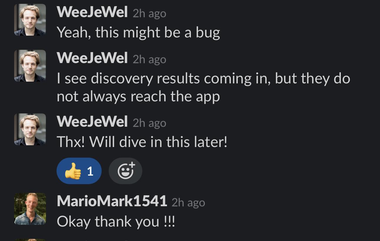

Little more research. It might be the newest rc version. I’m on 90. I believe emiel is looking into it.
If Emiel is looking there will be a fix
