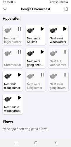

@Martin_Verbeek , i have the same issue again:
Homey doesnt play the card. It shows the error 'Encountered an unexpected error value: “undefined”
When I select the device option in the card, it doesnt show any mini. Just the broadcast to all (which also doesnt work).
Anything i can do ? in the past, a restart made them appear again, but now it sadly doesn’t.
I tried the latest verison on HCS, Cast to google and sonos and the normal verison. All have the same issue.
afbeelding
@Glenn_Dijkstra yesterday none of my smart speakers got listed, today only one is missing and it’s no playing… maybe try to share the debug ?
