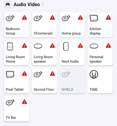

I would like to understand why, since moving last year to the new Homey pro from the old round one, I’m having problems with the Google Chromecast app. When I’m trying to connect with any of my audio chromecast devices, but only one is appearing, the Google Chromecast dongle that is connected via ethernet cable as my Homey.
Is there a limitation in the app that is taking into account only the cabled devices if my Homey is connected via ethernet too?
Do I have to connect Homey to the WiFi to discover the other devices and then switch back to ethernet?
Anyone else in my situation?
Any support is much appreciated!
Thanks a lot!
Alfonso
It really is unimportant how a device is connected to your network.
The important part is, both devices should connect to the same subnet, like, 192.168.1.x
Thanks a lot, I have solved part of the problem restarting my router.

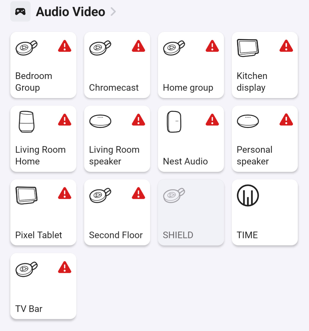

However, some outs ago I have all the devices that are not available, and restarting the app is not solving the issue.
Any idea?
What do you mean by “all devices”, is that all Chromecast devices?
Yes, all the cast devices a part from my Nvidia Shield, that is the only one connected via ethernet
