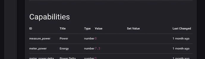

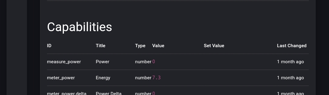

Hi Peter, thank you for your help. Strangely, both those attributes are used in the app as you can seee in the screenshot. But Homey does not recognise the device as a Power Meter. Maybe a device can’t have two functions? Homey does recognise it as a Solar energy device, ie it shows up as Solar Power in the Energy tab.
I see! That’s correct.
There’s nothing else I can think of. It’s best to contact support as well I think. Support | Homey
