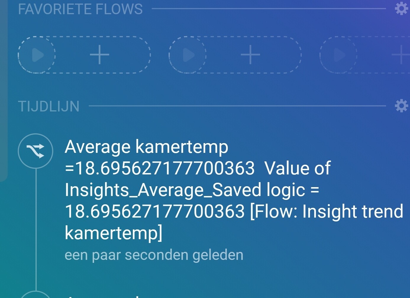

I’ve created a logic NUM var:
With this flow I store the calculated value to the ‘Insights_Average_Saved’ var:
https://homey.app/f/FqRV1x
Outputted values:
Edit I see now​:laughing: Flow 2 gets triggered when the calculation has finished. Didn’t get that at first :upside_down_face:
(Orig: While I’m just testing, it seemed handy for me to start flow 2 with flow 1, and then get my calculated value as in “real life”)
