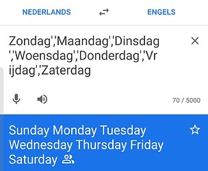

Would it be too much trouble to switch to English when making screen dumps?
If you mean the weekdays (the rest is in English?):
Actually I ment the screenshots from your phone.
BR
Thomas
Thanks Thomas, I’ll try to remember switching to EN first when taking screenshots. Oh crap, I just discover Homey has to restart to change the language :flushed: :nerd_face:
Which post do you like to be Englified @Kindbo?
I just don’t read more than English and Swedish, so every other language makes it harder for me.
I am Swedish, but use English for Windows, Android and Homey. That way it is easier to search for help and apply what I find.
