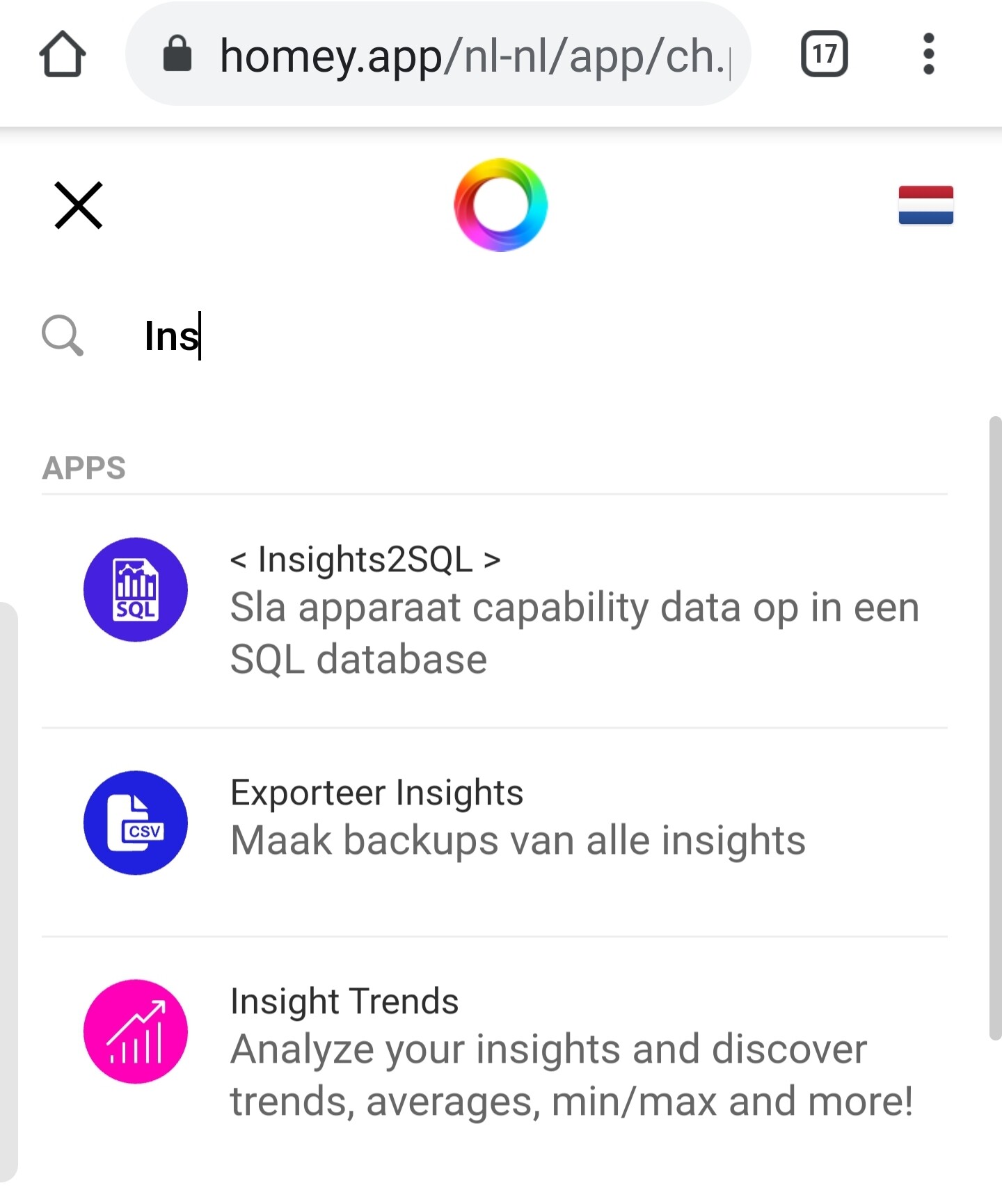

Is there a way to calculate an avarage over a certain period, f.e. take a value every 30 mins and calculate the average on the last 30 values that were taken (so the value is an avarage over the last 30 mins)
I’ve tried a couple of times but I soon get stuck into a difficult web of flows and variables, maybe I’m overlooking something
I googled and came to this tutorial which mentions an average, but is far as I understand it just an avarage between 2 or more sensors that is talked about in the OP

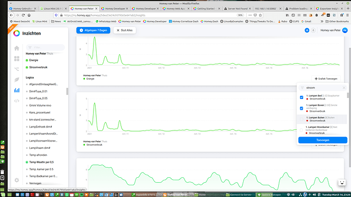

Did you check Insights i.c.w. the Insight Trends app?
With the Insights Trends app you might have your answer
https://homey.app/nl-nl/app/ch.philippewechsler.trends/Insight-Trends/
There are 3 Insights apps available b.t.w.:

If I want to view the Insight data from Homey and then the detailed 6 hours I have to turn on the PC in the morning and sometimes I am already gone. So if the app could do it, it would be great.
Where does the app possibly write it to or where can I have it written if the app can do this?
So that I can see what consumption does afterwards.
Insight trends takes one value over time as input. Not an array of f.i. all power values…
From what I understand the most simple way is to export Insights to .csv (for use with Excel) with this app: Exporteer Insights App voor Homey | Homey
In Excel you can sort stuff, and probably find the culprit that way.
I know you were looking for an automagic way but… This is also an option:
An alternative way is to open my.homey.app on a laptop or PC and click the Insights symbol on the left. Open a random graph, on the right of the graph, you’ll see a “+Add Graph” button. A popup appears, and you can filter all available graphs. Enter ‘Power’ f.i. Now only graphs with Power as measure phrase are selectable. Select all the available items.
Now you can fiddle with the timeframe selection. Take “last 7 days” f.i. Now I think you’ll find the culprit by scrolling down all the graphs.
