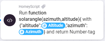

Get value from homeyscript in a variable that can be used in advanced flow
I would like to use the value returned by the function as variable so I can use this one further in the Flows.
I don’t know how to register this value in a variable (not in homeyscript nor in Flow).

Maybe I misunderstand you, but have you tried the respective logic flow card (sorry, screenshot is in German):
Connect your homeyscript card with the logic card to set variables, select the variable in the logic card (add it if necessary in the variables menu at the top) and select the tag #Result as value.

Now I just have one more problem to solve:
When I check the return value in the script, I get the expected number so I don’t understand why I get this error message. All values of the variables were checked and are correct and only numerical.
Can you share your flow?
Returned: undefined
So your script isn’t returning anything.

Can you see why the script would not return the value?
Your script only declares a function but doesn’t actually call it. It also doesn’t do anything to parse the argument.
Try adding this at the end of the script:
const input = JSON.parse(args[0]);
return solarangle(input.azimuth, input.altitude);
Thanks a lot!
It works now!
