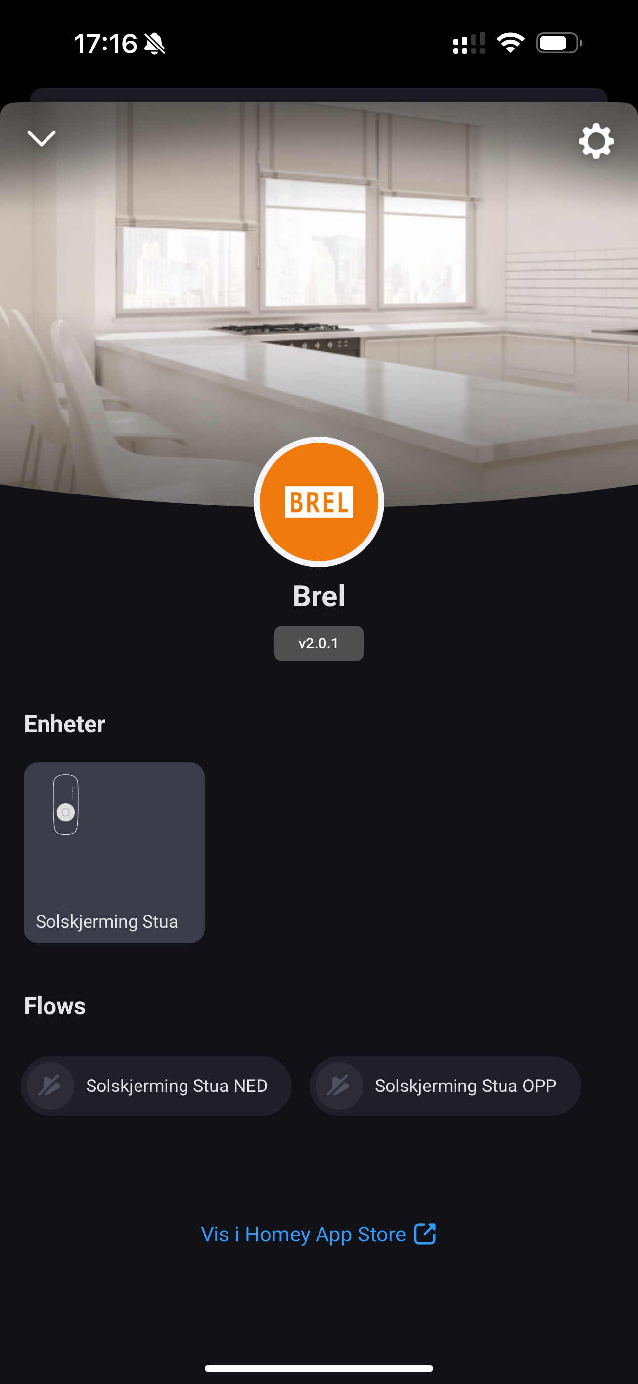

Hi, I ended up with this app. Works perfect :ok_hand:t3:
