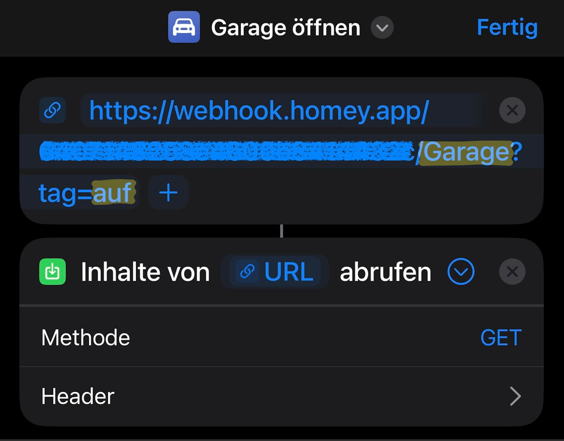

A workaround could be to use the Apple Shortcut app to create shortcuts with webhooks for opening and closing the garage. If you have an HP23, the shortcut and the webhook should look like this:
(The hidden area is the Homey ID)
The flow should look like this:
You can freely name the Siri shortcut, e.g. “Open garage”. Siri responds to this title and starts the flow to open the garage.
This is the way I control our garage.
