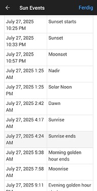

This might not directly answer your question, but I highly recommend using the Sun Events app.
It offers many more flow cards and possibilities compared to the two standard Sunrise and Sunset flow cards in Homey.
The Sunset and Sunrise flow cards in the Sun Events app are accurate down to the minute (at my location), probably yours also😎
Be aware of this:
Sun events for tomorrow are not available. This means the “Between” condition won’t work as expected if you’re trying to create a flow that spans from sunset today to sunrise tomorrow. After midnight, “sunrise today” becomes “sunrise tomorrow,” which causes logical issues. So, the “Between” condition only works properly with sun events that occur on the same day.
