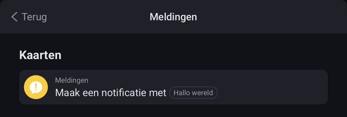

Put timeline commands at start and end of the flow. That will tell you how long it takes to execute and whether or not it’s being called multiple times.
Hmm. Being daft here, how do i add timeline commands please?
Ha always learning
Thanks
In the THEN section, when adding a new card, go to the Notification section (‘Meldingen’ in the below screenshot in Dutch) and select the one flowcard that is available in that section. It allows you to add a notification to Homey’s timeline:
