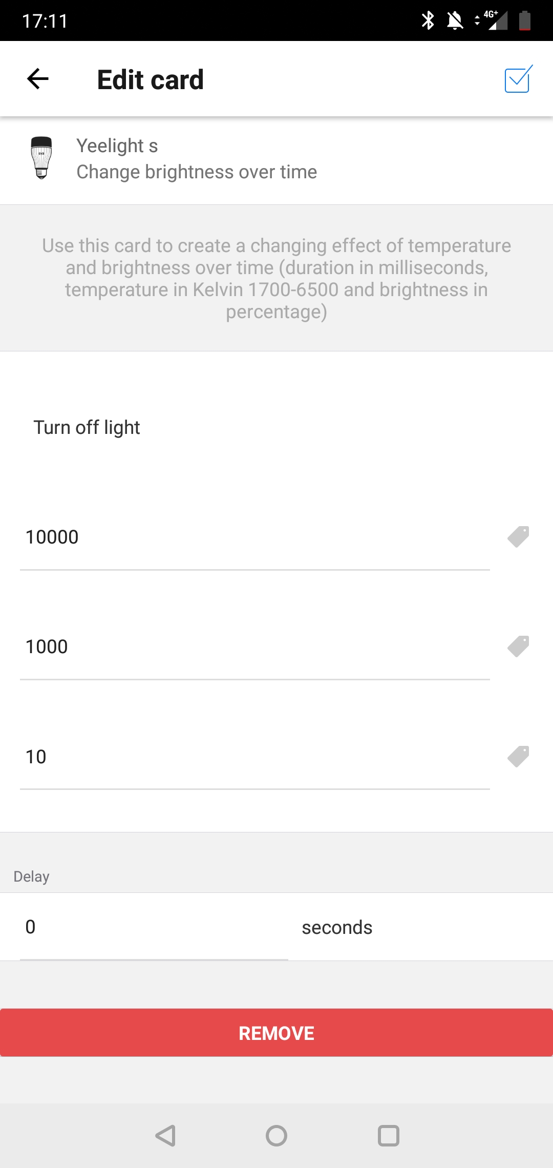

For the when sleeping flow its pretty straight forward i think. When motion is detected and aanwezigheid someone is sleeping etc set the light to specific values of your choice. Keep in mind you have to activate aanwezigheid sleeping somehow.

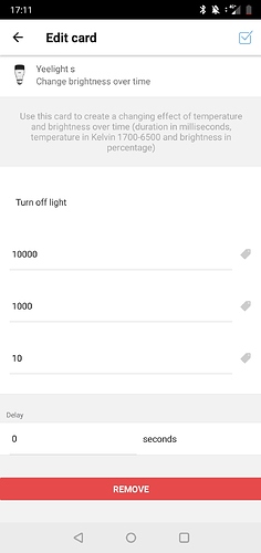

I do use the wijzig helderheid card. I use it to dim a light before turning it off when the door is closed. I have used these settings.
But again just try some settings to see what Suits you best.

Could you tell me how I get to these card settings? What / where is the step before this card?
Edit:
I know I have to look in the settings of the Yeelight bulb. The point is that I don’t see anything like your card. Does that mean you have a different app?

The screen was taken from the homey preview app on android.
